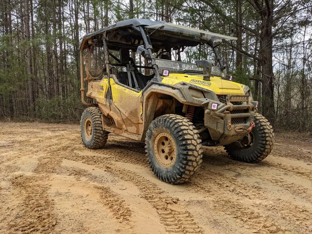

No lift, forward and rearward raked arms. Only have experience with the satv front/rears but other than the crappy bushings they've been great and I've not been kind to them. I run @RB3offroad 1" spacers in the rear and 5+2 wheels all around. This puts me at +2 on the front because the stock are basically a 6+1. You don't really want to go any taller unless you play in the mud.

What size tires? Brand?
