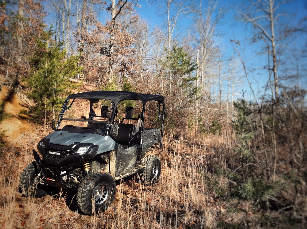

I just put one on mine about 2 weeks ago. Same boat as you, I wanted something easy to take on and off and didn't want the added height, and imo it looks a little better than the hard tops. I trimmed down the fiberglass rods about 1.5 inches so they don't prop it up as high.

A word of advice on trimming the rods, take a little off at a time because a small amount makes a pretty big difference. Also, I used a hack saw and don't use much force, basically the weight of the saw and make a ring all the way around it before cutting through, otherwise it wants to splinter. Oh, and wear gloves.

Do you have any other pics showing the soft top with the rods cut down 1.5 inches? Did you also cut the one that goes side to side? I’m thinking about doing this because of how much taller they make the whole machine. I just can’t tell too much by this pic. Thanks!
