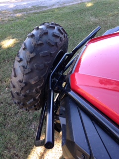

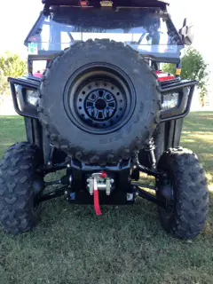

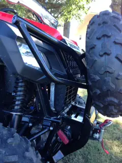

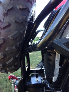

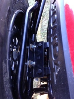

When I returned from the dealer with a new winch and front bumper on my 500, I also had a new spare tire for it. I was fix'n to make a trip to Colorado with my Pioneer and wanted a spare, the problem was where to put it. I looked at the roof, but didn't like that idea, the back rack would be used for ice chests and other necessaries. Then I noticed the front bumper was mounted on in the center by 2 bolts.
Tire2 zps2f6e5cd9
A piece of 1 1/2 angle about 7 inches long, 2 holes bored on each side, 2 for the bolts holding the bumper on, 2 to hold the tire on. I used two either 6 or 8 inch eye bolts to hold the tire on with nuts on both sides of the angle iron bracket. I run a tie between the eyes on the bolts to keep them from loosening and with the eye bolts I can remove them with out tools.
Tire5 zps84f4314b
Tire1 zpsd4989273
Tire4 zps81190a5d
Tire3 zps11fcde3d
It's rode there for about 4 months now, 2 trips to Colorado and lots of mud here in Arkansas, and it's still riding good. Plenty of room between the tire and the grill for air, no over heating.

I really liked having the spare mounted on the front, besides being out of the way and handy, it made a great front bumper. I took it off though. When I had the tire up front I had my winch mounted on the low Honda winch mount and it stayed wet and full of mud. I put a higher winch mount on to get it up out of the water and mud, but when I did the spare was in the way. Later I ended up mounting a 14" led light bar on top rail of the front bumper, too. That would have meant moving the tire too, if I hadn't already done it. While it was mounted to the front I had no problems with the 500 overheating, at all.

I recently made the same front spare tire mount. I used 1-1/2 x 1-1/2 angle steel 1/8 inch thick and 7 inches long. I also used 1/2 inch eye bolts 8 inches long from Tractor Supply. I welded the nuts facing the radiator in place and used the other 2 nuts facing the spare tire to lock the assembly in place. I faced the tire with the deep well portion facing forward to help funnel the airflow to the radiator. I also used a wheel with openings around the edge for better airflow.
