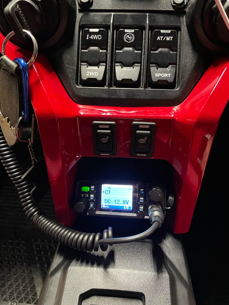

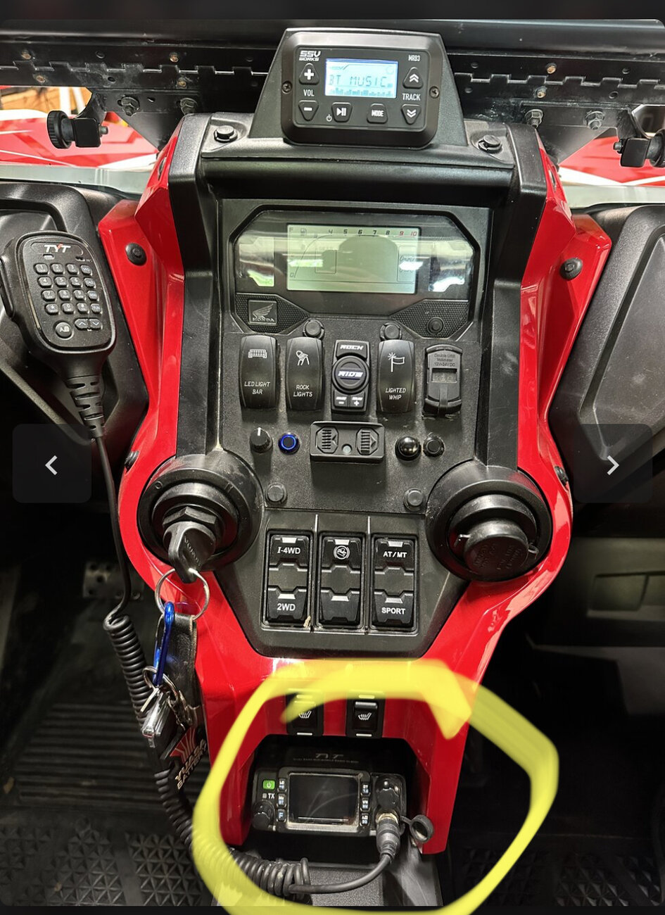

@Indiana SxS what radio is that, brand. Do u have a link by chance?

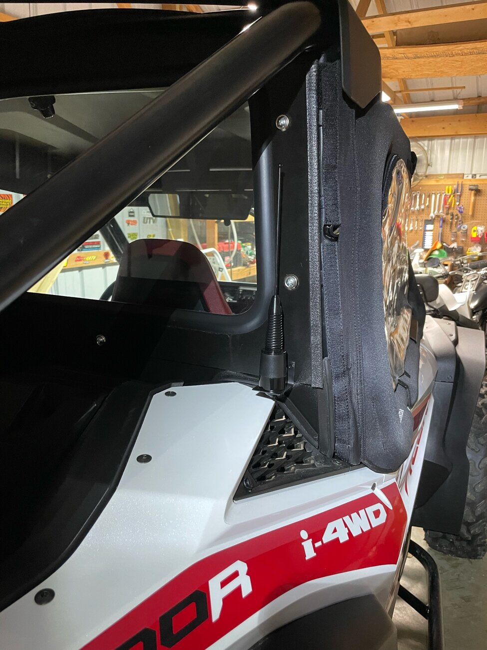

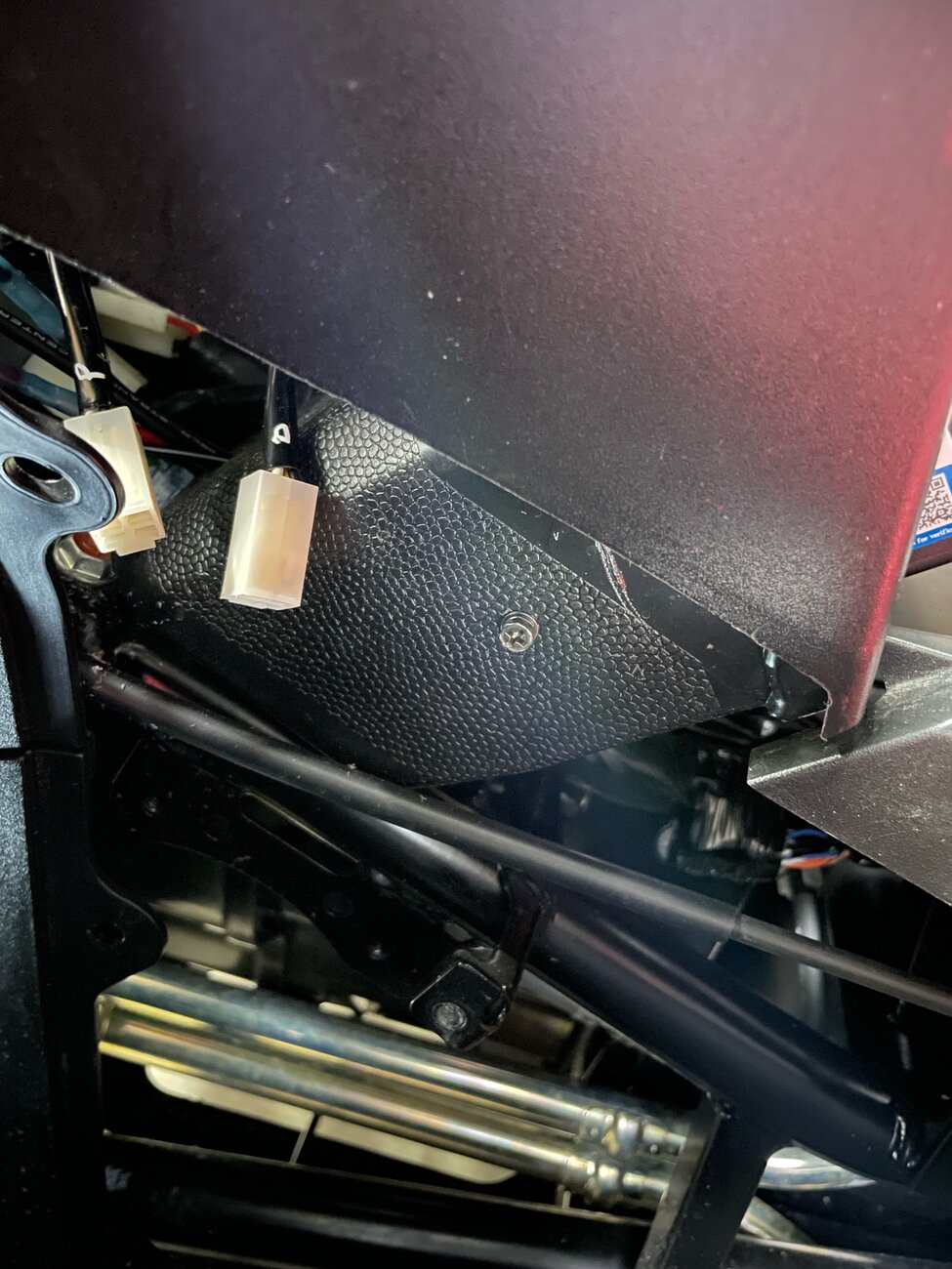

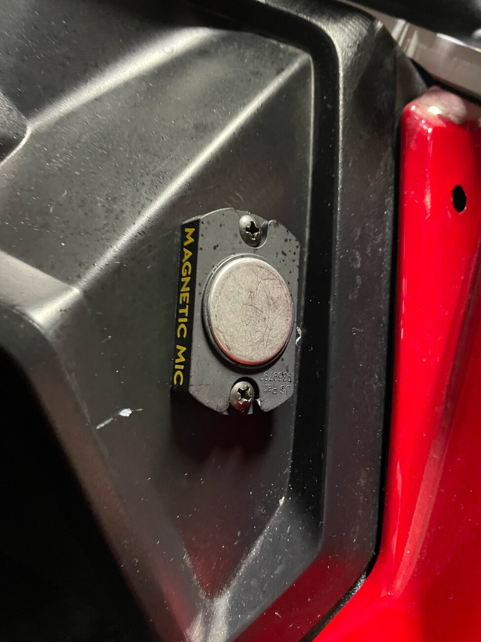

It’s a tyt th-8600 gmrs/frs. You can buy them on Amazon, eBay and several other places. They are waterproof and work great.
Rugged radio also has a version of the radio. It fits in the pocket there like a glove without the mounting bracket. All you do is measure how far back the screw holes are in the side. Put it in the cubby and ensure the plastic is pulled back on the side. Then take a metal pick and poke through the side of the cubby and look inside the cubby that the pick is lined up in the screw hole and drill a hole just big enough for the screw and screw in both sides. Put the plastic back on and you’re done. Well, you also have to drill a hole for the cable out the back and caulk it. Enjoy this short novel as well :), I’ve spent some time making everything fit perfect and took photos of the processes. :)

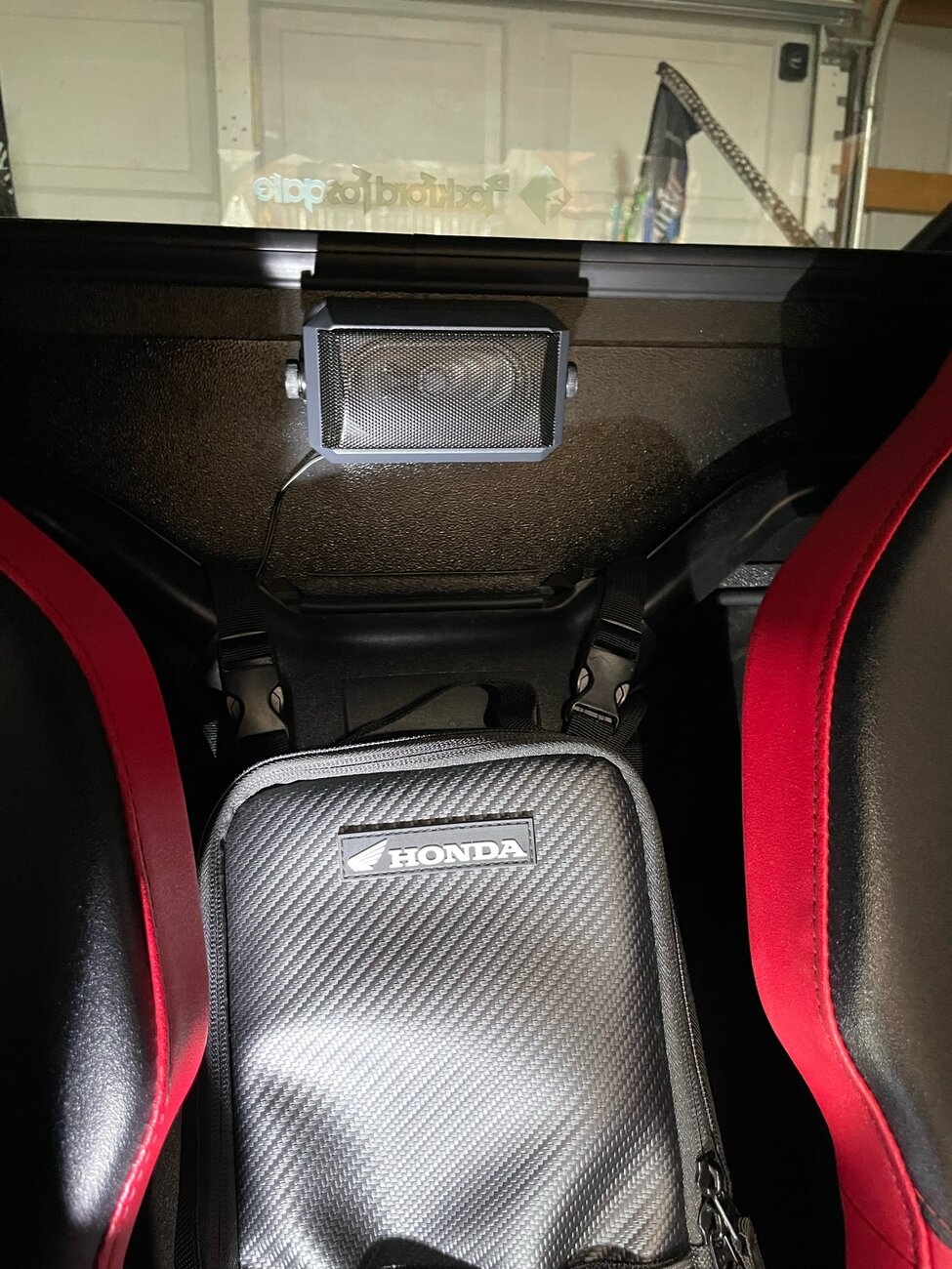

Can you give me info on the speaker? I cant hear mine in a simular spot.
If you are referring to the two way radio speaker it is a RoadPro RPSP-15. They’re only like 15.00. It makes a big difference vs the talk coming from the cubby hole and if I have my bazooka fans on that I mounted in the seat belt holes on both sides of the Talon.
