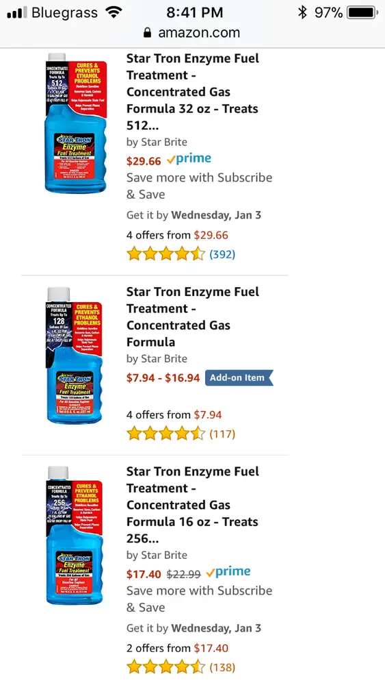

I’ve wanted to buy it but dang it’s expensive. I keep finding the Marine Stabil for sale at $18 for quart. That’s not too bad. I’ll try some next time and see how it treats me.
One ounce treats 16 gallons.. the small bottle is 8 ounces..

I have seen it at our local Ace Hardware and I can’t remember the price but I definitely wasn’t going to buy any. They typically seem to be higher on everything then other hardware stores in town.
Is that Amazon price pretty close to what I should find?
I usually buy it at Walmart... they usually have the small bottles and they’re $7-8... so yeah, Amazon is right there. I don’t use a lot of it as we have conventional gas around here and I try to use it in all my older equipment, small engines and other machines that don’t get ran a lot.
