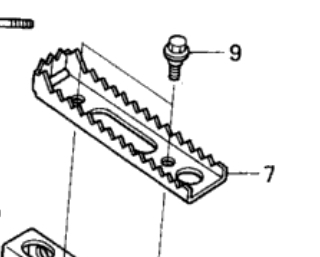

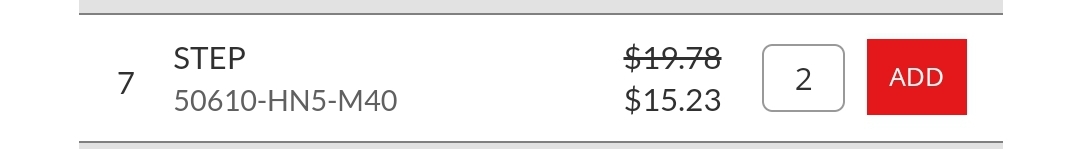

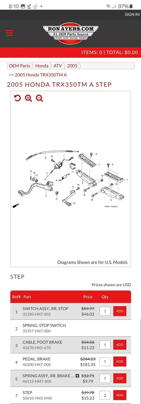

Get you one of these and bolt it to your brake pedal for easy 2 footing stopping on steep ass hills.

View attachment 427234View attachment 427235View attachment 427236
Get you one of these and bolt it to your break pedal for easy 2 footing stopping on steep ass hills.
