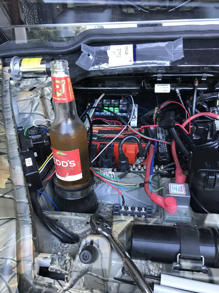

I bought the plug and play harnesses. I made my accessory receptacle hot all the time and connected the key on wire to a bus bar. Now I have the ability to connect multiple accessories to key on power. Have had no issues so far. It's just to the right of the beer with the red wire going to it. It has a plastic cover that isn't installed in the picture that goes over it to prevent an accidental short.
That is a great intake plug!
