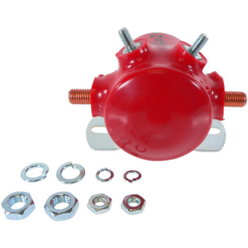

tyco is good too but all really best thing on a quad or utv is water proof, water resistant doesn't have to mean any more than just a cover over the coil
they have waterproof 40a relays with plugs and pigtails on amazon for 20 to 30 bucks, that's what I would get

I chose my part based on IP rating... That Tyco is rated IP67... second best water ingress protection rating. Electrical devices will generally have an IP rating...

Being in Alaska, on an island, I am always driving through water (well above the axles) I call it my trail boat. All my electrical accessories utalize marine grade wiring and relay is PVC coated and 85 AMP rated picked up at the local marine store. Never had any issues with it.

Good info. For the record, my machine has never been in more than 3 inches of water, crossing a creek at 2 mph. There is no way the Stinger was hit with water or rain where it was mounted. Some light snow got blown under the hood so maybe melted snow moisture that got in the Stinger causing it freeze? Pretty lame. Today it is 46 degrees and no issues with the Stinger switching my panel on.
I will be replacing it with a waterproof one. I haven't decided which one. I have an extra MotoAlliance winch relay I could probably use. It would be overkill but it's just sitting in a box on a shelf in the barn.

[HASHTAG]#RedFred1[/HASHTAG] How many continuous amps you think this will handle? Some web pages say 65 amps and others 85 amps
It says it is a direct replacement for a Cole Hersee 24213-bx which is rated for 200 amps... I am waiting for their response on a catalog cut sheet from the other day. If I get a catalog sheet I will post it here...
The cole hersee is $44+. it is also not sealed like that one.

I saw them call the sealed one a 24117. I'll await your results before making a decision

What I have learned about ratings in the USA, is there is usually a big safety factor calculated into them. Not to mention much better quality control than the Stinger brand. I would be confident running that in my own rig. And chances are, if mine gives me a headache, it will get replaced with a Cole Hersee marine rated unit.

I talked to DBelectric… There is no cut sheet or spec sheet available... it is a part modeled after the Cole Hersee 24213-bx by a Chinese manufacturer. He said use those specs for your guidelines.
I expressed my concern about no technical info being available... nothing...
Looks like a good product, but so does the stinger... I guess you place your bet and take your chances.

Looks like Cole Hersee only offers 3 marine rated solenoids.
Capture35
Drill it down further to Continous duty, and 12v leaves the 24117.
Capture36
~$30 on Amazon
https://www.amazon.com/Cole-Hersee-24117-01-BP-Continuous-Solenoid/dp/B001Q8KONI/?tag=sxsweb24-20

Here are the spec sheet and the install guide for the Stinger... notice how it just says water resistant? Not an IP rated device.
