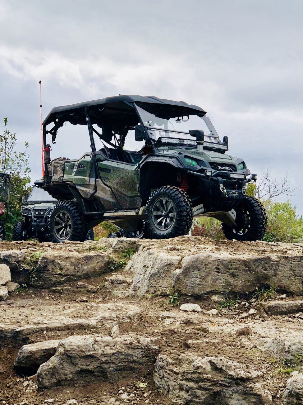

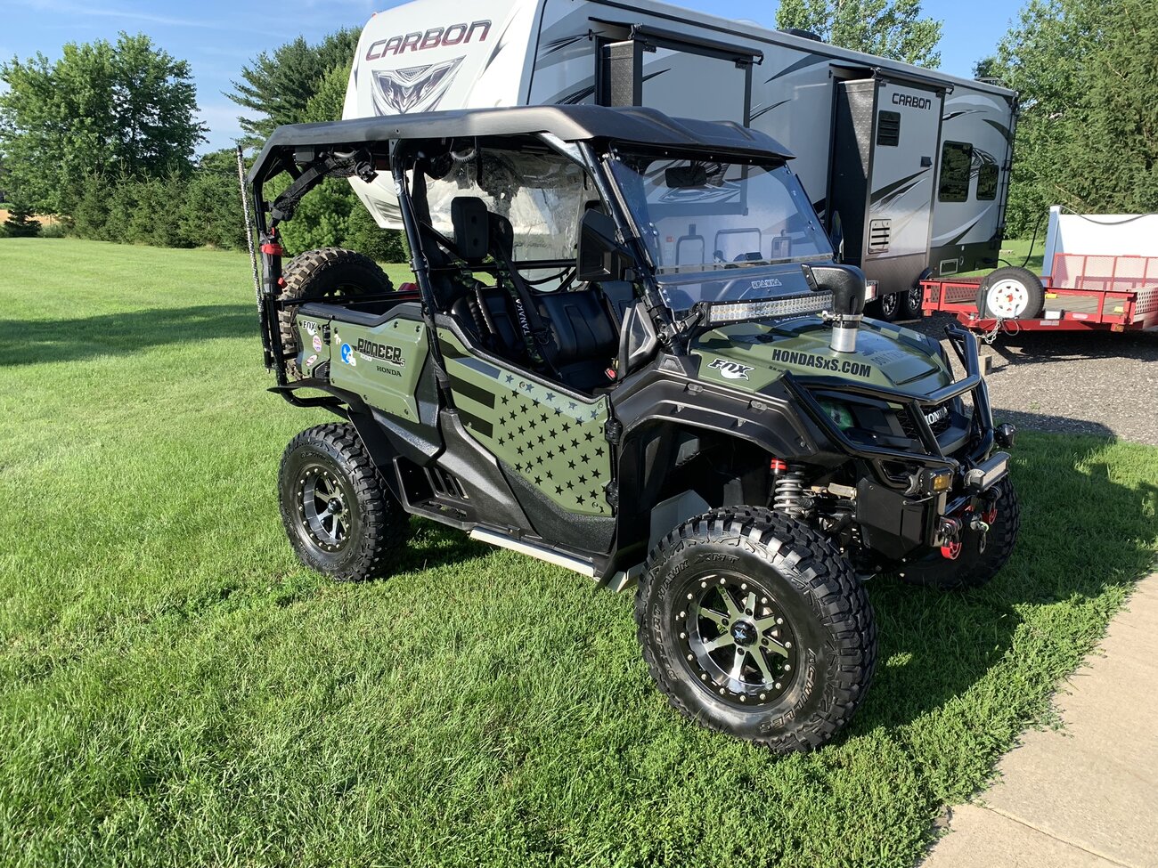

Have you seen this done? Just trying to save a buck or two. Does this make sense to do it this way? Still won't have a spare; but will have an extra four wheels that only fit on the back.
Saving cash in the long haul….you might want to consider buying a full set of 15” rims and then get LT tires on them. They will wear way better than SxS/ATV tires. Just something to consider. There are several members here that have done it.
18,468
105,278
Yup, me 7 yrs ago and today.
top pic is currant and with LT’s 15” wheel
26D8D6E1 14CF 4B8A 82DA 8229F841F644

Should be. Will be a tall tire. Will just have to do it and see what it look like in person. Trial and error!
thats how most of us have done things around here ;)
