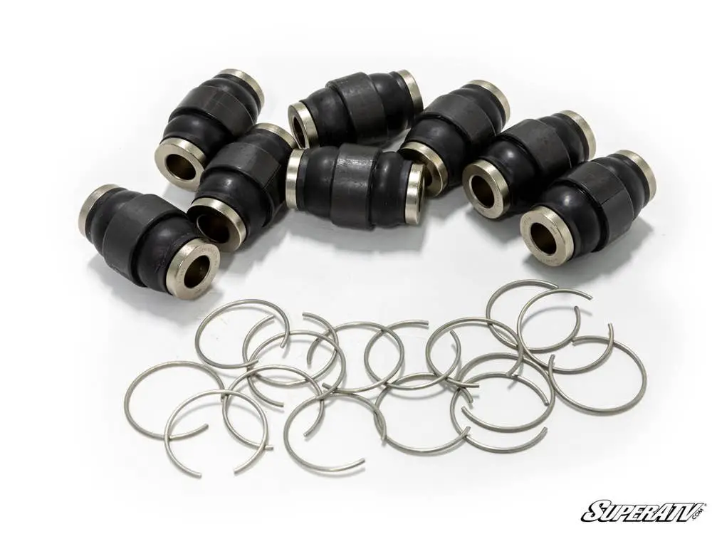

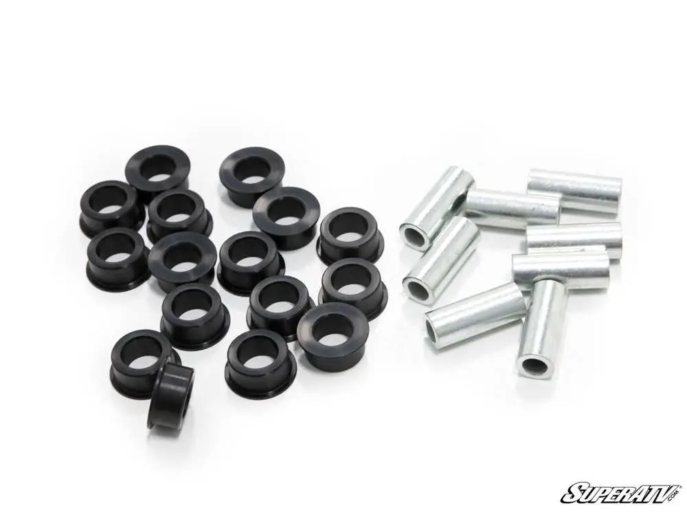

Honda doesn’t offer the front A-arm bushings so the cost of the 4 A-arms is going to piss some customers off. The 4 A-arms cost $940.00 Some of the dealers are not going to look for Aftermarket bushings. I don’t ride in deep water or mud so the factory bushings will last at least 25,000 to 30,000 miles. I just ordered the bushing kit from Super ATV. They have the OEM type and another type that are much easier to install.

Are yours worn out ? If not , why did you order them ? If so , how many miles did it take you to wear them out ?

The "other" type are garbage.

The aftermarket bushings lasted about 5,000 miles. I still have some and they are easy to install so I will use them up then install the OEM bushings from Super ATV. A couple of the guys said they wouldn't last. I didn't know the OEM bushings from Super ATV come with the install and removal tool.

Thank Bob. Good to know the "easy" ones to replace lasted 5K. I'm guessing in the crap I ride in I might get 2K out of them. I'll look at both options on SuperATV and go from there.

I ran 2 sets of the UHMW super atv bushings. Both sets lasted 300 miles, I wouldnt even waste your time. Some of the bushings came sloppy out of the package. The OEM style are much better, on my second set of those as well. 5th set of a arm bushings in 6200 miles. OEM lasted the longest.
Your in PA, so we ride in the same conditions. Good input. Thanks!
