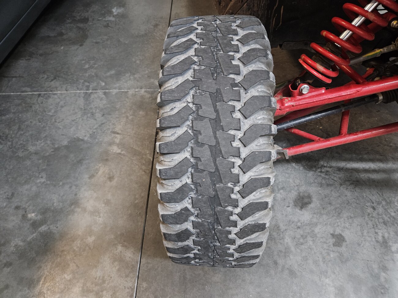

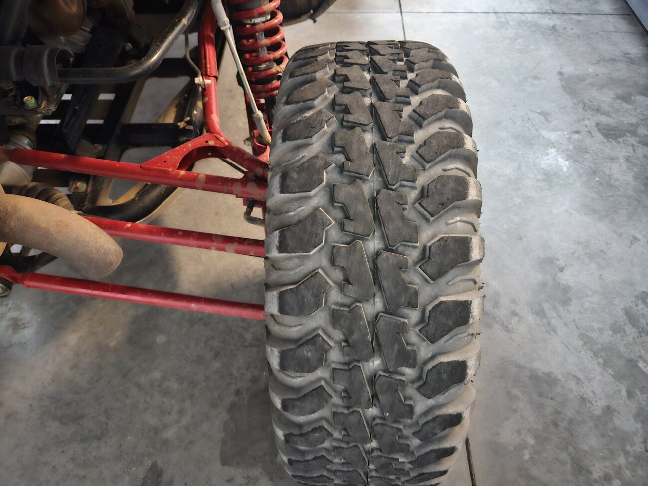

I wouldn’t think that high front pressure would cause wear like that, unless it was for a million miles, or going really slow and turning a LOT. And with that being said I would think the back would be worn the same or more if they were all equal.

To me it’s too much pressure and alignment on the front. If your running larger tires than stock you might want to consider psi around 12 or so.
As far as quickly determining toe…if a center line isn’t obvious on the tire, going to the inside lugs on front and back should give you an indication.
I prefer to have 1/8” toe out…imo it doesn’t hunt as bad on hard pack vs 1/8” toe in IMO.

On my '21 R two seater, the rears wear twice as fast as the fronts and have done so for 14,700 miles. Almost all dirt, very minimal pavement.

Running an overinflated tire causes the center of the tire balloon. The front appears nearly slick in the very center and increase a tad towards the shoulder of the tire. I'm guessing the heat and temperature of the pavement or rocks has greatly warmed the tires causing them to expand even more. I doubt he rides on overcast rainy days in Arizona. Running it through corners could definitely increase the wear considering the increased friction from changing directions and the rears only trailing, thinking back to the pencil eraser days? I seriously doubt the tires were checked on his machine until someone thought about needing to buy new set. IDK, just a theory? Oh Silent One / Jacob always has my tire pressure spot on, not close, on the $$ and I wouldn't expect anything less. How would I know, you ask?

On my '21 two seater, the rears wear twice as fast as the fronts and have done so for 14,700 miles. Almost all dirt, very minimal pavement.
I'd say you have mostly sandy soils thrown in with very abrasive rock. Slow down and stay out of the clouds if you're looking for the Honda SXS Club Tire Mileage sticker. Funny huh?

Unequal air pressure front to rear will cause tire scrub due to the difference in rolling radii when in 4wd
Also, are the rims wide enough for the width of tire your running. If they are too narrow it will cause a rounding of the tread and cause wear similar to overinflation.
