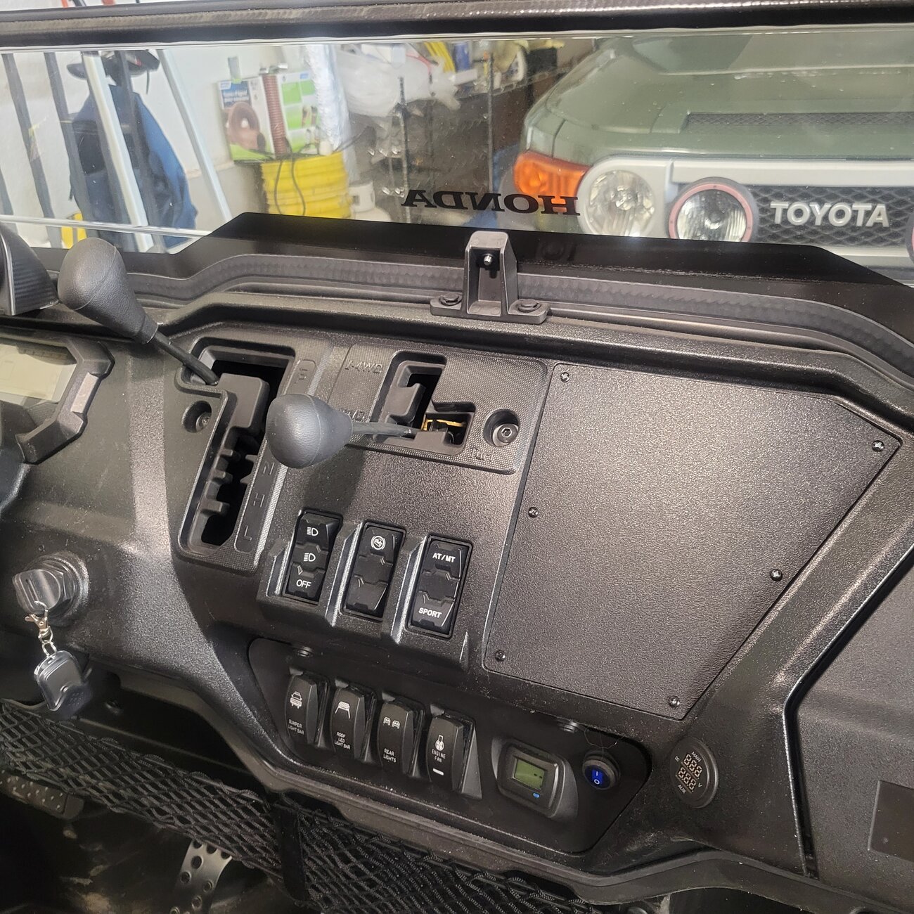

That passenger side dash panel was intended for use with mounting navigation, phones, tablets, etc with magnetic bases.
I designed the attached center panel for switches closer to the driver. I never pursued this design because other people are already making similar panels. Mine would be aluminum of course.
Once I have my own cnc plasma cutter that will free me up to do anything one off custom for you guys. I'm just not quite there yet.
Talon switch plate Model

The fasteners look a little large for the application. What size are they? Also, what is under the warning sticker?

The fasteners are the same size plastic snap rivets everywhere else on the Talon. They may look larger because the original rivets were so small.
Under the safety label is nothing but black plastic. The safety label is metal, riveted AND glued with some good glue to the dash.
I can't use nuts and screws for the new panel because I can't get to the back of the dash there.

I want to remove the safety warning plate, it causes a glare on my windshield. Thanks

Sorry, no Talon. I replaced the "You're All Gonna Die" warning panel (the biggest portion of the dash!) with a textured ABS plastic panel on my '21 P1K-5 SE. Rivnuts replaced pop rivets, so it's easy to pull for mods and wiring access. It'll probably get a small radio. For now, I left most of the sub-panel plastic in place for rigidity when mounting heavier stuff - - with your metal panel, that wouldn't be a concern. I have no plans for magnetic mounts, though that's an interesting approach.

These rivnut fasteners are definately a great idea but everyone will not have the tools to set them in place. That's why I stuck with the snap rivets that anyone can use. Now, I am looking at using the flush mount type like along the Talon center console but they are not any smaller.

I can't promise anything ASAP but will check with the shop on Monday. They are only powder coating one more time this year the second week of december. I may be able to have one cut for you. We aren't quite at the production stage yet but I'll see what I can do. I have dimensions for switches but can you provide dimension for heater vent hole?

I used this tool-less alternative to rivnuts when I took the safety decal off my dash. Just used a 10-32 bolt and a washer to set it. It works well.
However, I’ve found so many applications for rivnuts, I finally bought a rivnut puller. Everbody could use an excuse to buy more shop tools, especially if you have the Honda SxS spending addiction.

Final panel size fits well. The actual finish with be smooth matte black for magnetic surface or suction cut if desired.
A49CD36E 8575 4BC5 905A 607EEDA5D3BB
Will have the first batch in my hands by end of next week, 12-17-21.
Cost will be $30, with the standard Honda style plastic rivet fasteners, and shipping. Updating the website store soon with this listing.
For those interested in using a magnetic phone mount, Mob Armour makes a STRONG mag mount. Definitely worth looking into.

Dash panels are in stock as of today 12-17-21, for those interested.
Store link here
The laser guy said to call this a warning label delete kit...so I added that to the description.😆
On the riv nut fasteners...
I looked at McMaster for dimensions and found that the riv nut recommended for plastic applications is only very slightly smaller diameter than the push rivets that everyone is already used to so I'm staying with push rivets for now.
