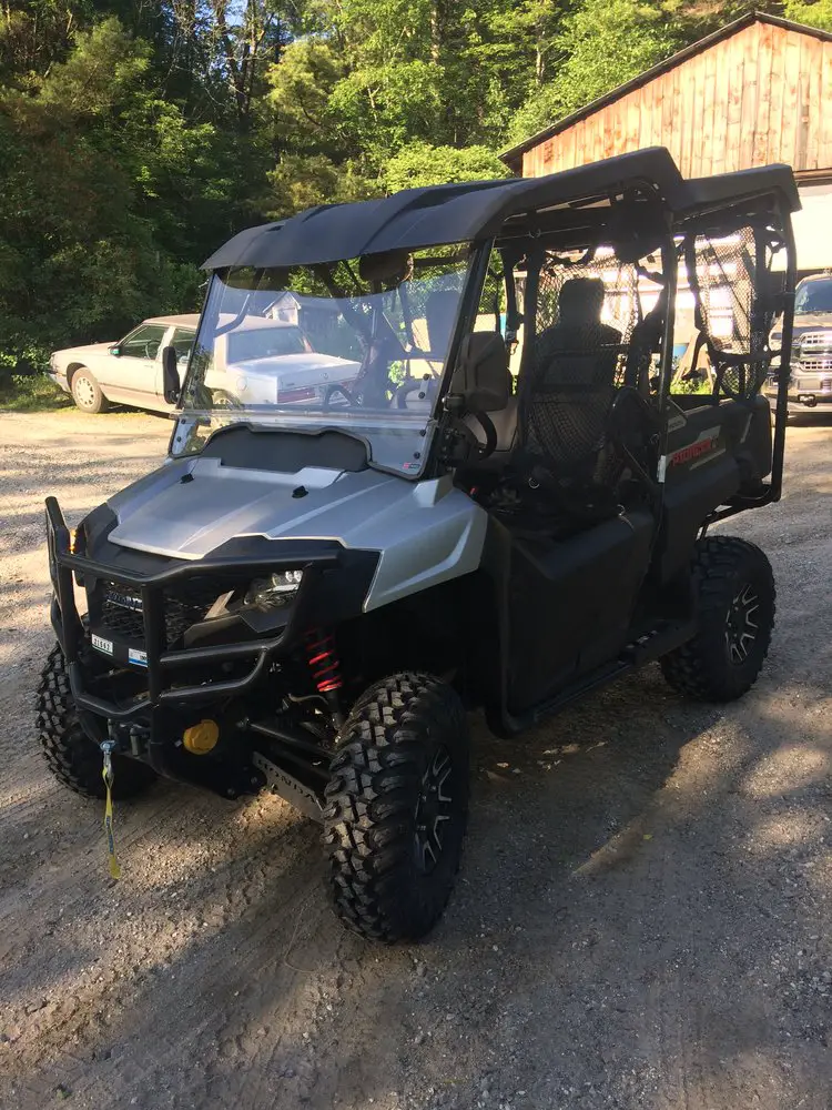

Did you go with 27x9x12 and 27x11x12 or 27x10x12 all the way around.
I went with 27x9 in front and 27x11 in back. Maybe 400 miles and couldnt be happier. Most of my riding is harder packed logging roads or blacktop and gravel with occasional creek crossings and soupy plowed fields, but never anything deep. They do best on harder pack, but havent left me stuck yet either.
