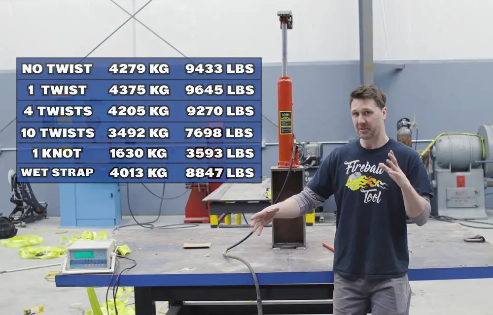

An interesting test of ratchet strap breaking points and the effect of twists, knots and wet straps. Just checking out his shop and tools was interesting.

Very interesting, looks like fun! Wonder how that compares to driving over a loose tag end?

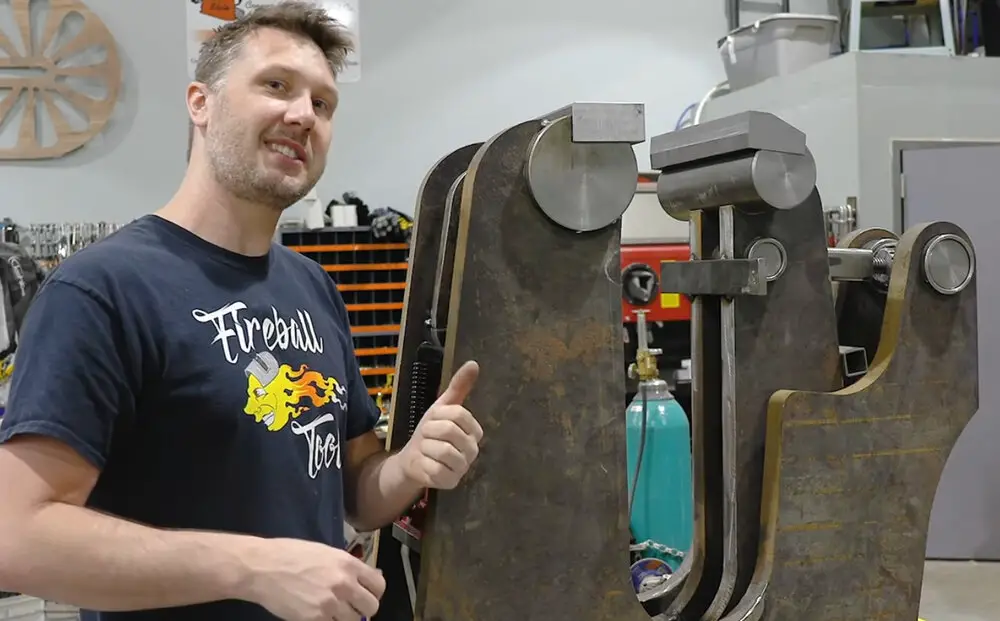

He has part 1-4 build videos on the giant vice, 30K lbs of jaw force. Parts 2 and 3 are awesome metal working. Amazing to me as a wood worker what he can do with metal and machinist skills.

Thank you very much for that. Some of those machines I've seen in action, many I have not. But I always love watching competent metal working. It really is a skill, and this man has it. Woodworking skills too!
We have a few HAAS CNC machines in our small machine shop, ad well as an old school Austrian machinist who works solely by hand. A pleasure to watch both in action. I'm an old school layout/fitter that relies on a torch, grinder, & welder myself, but we do have an automated beam line & automated angle line. They work great, but guess where they come running when they break 🙄.
