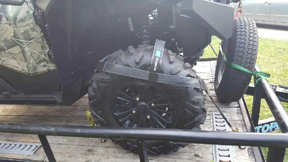

I'm needing some ideas on tie down spots for the front and rear, Has anyone modified or added anything to make strapping the vehicle easier?

The front are bolt on from TS ironworks in AZ

The rear are $7 eBay straps that use a factory hole in the frame.

I made my own washer plate which was required to keep it from pulling thru.

Tire bonnets or axle straps through the wheels are definitely the way to go. When I see people tie down their almost 2000lb machine with a 1" strap at the front and back it makes me cringe.

Here is where I tie it down for transporting, click on thumbnail for larger pics:
TD Front TD Back
