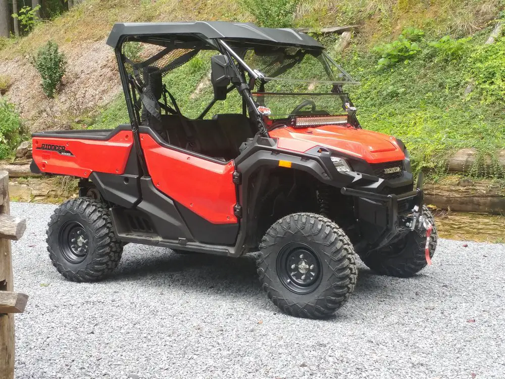

Hey guys I'm new to club not sure how it works but been reading the problem I'm having is finding a 27" tire and 12" rim that can handle loads of p1
Dasmoeturhead
12" diameter Tusk Terrabite I believe are 27"
I run the 9in in front and 11's in back. I think there a pretty good 8 ply tire, but they don't fair well against mud IMHO.

Thanks for responding not sure how to respond reply or start a conversation this is first time been a member of club seems like it will be great once I figure it out I have a p1 eps orange 2016 just got clutch upgrade and cabin heat trying to get good tires without getting new rims most of my riding is dirt road and pavement some mud looking for a 8 ply tire like the Rocktains Xd but they only come in 14”rim size

Nice looking buggy looks just like mine just different color tires look like they would be smooth on pavement not sure how to send pics
