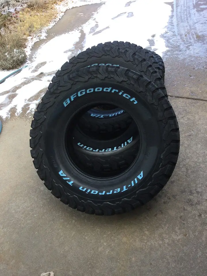

Those 32's are Tusk Terrabites, I found the sidewalls a little soft for the jagged rocks I've encountered, my current tires are 32" BFG KM3's UTV tire. I believe @CID is currently running 30" BFG K02's LT tire? The LT tires are a little heavier but cost less than UTV specific tires.
Yep, I'm running the BFG K02 in 30 x 15 but they ride a little harsh. They weigh 39.7 lbs. each without a rim. They're wearing like iron though. :) When I need another set, I'm leaning towards the UTV specific 30 x 15 KM3s hoping for a plusher ride (+ the Shock Therapy shocks). They're considerably more expensive than the K02's, like $60 per tire IIRC. :oops:

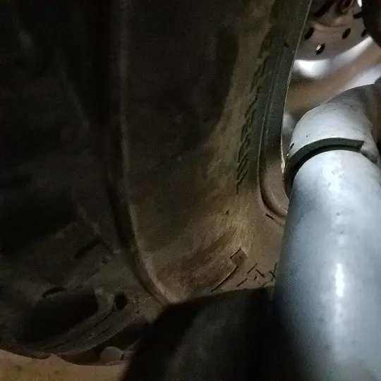

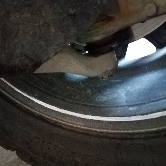

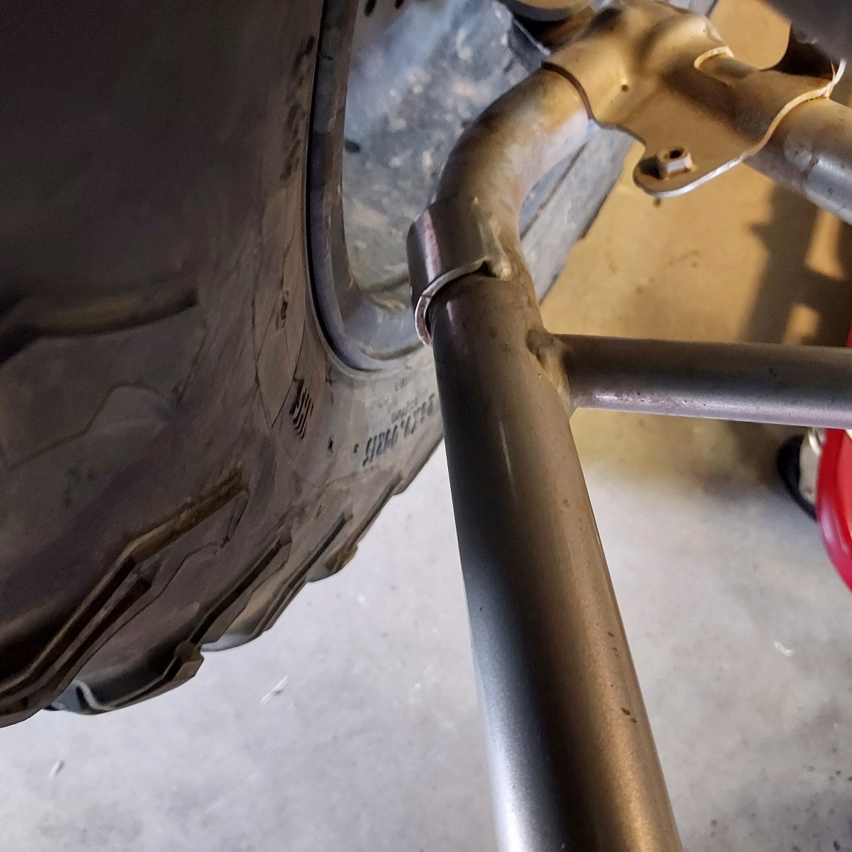

Check your steering rack and tie rods ends. I had to replace mine at around 24,000 miles and expect I will be replacing it again before 50,000. I'm at 34,623 miles now and have a little play. The large tires may need a steering rack at 20,000. Its best to check the left front at full lock. There is a tab on the lower A-arm and it should have about 1 inch of clearance when new. Mine is at 1/2 inch now.
View attachment 367982View attachment 367983View attachment 367984
Thanks for the info
