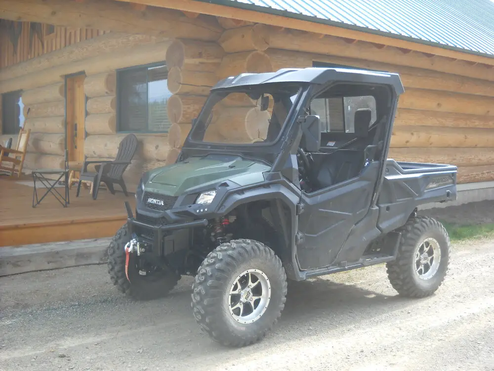

I just put 29” sunf ao33 tires on mine. They are a centimeter from rubbing. I’ve ridden hard and it is fine. I’m glad I didn’t do a 30 because they would not have worked. 29s look great and sunf makes a great tire. Especially at $440!! My profile pictures shows the tires.

I have 30x10R14 Mastodon HT's on my P1K3, they've been on there 1500 miles. The front tires do rub when I cut it all the way and go over a bump. It makes a lot of noise when it rubs but hasn't done any damage. If I use snow chains it will have to be on the rear only. Seems to me 29" tires would be fine but there aren't many choices in that size. Suspension is stock other than Fox shocks.
