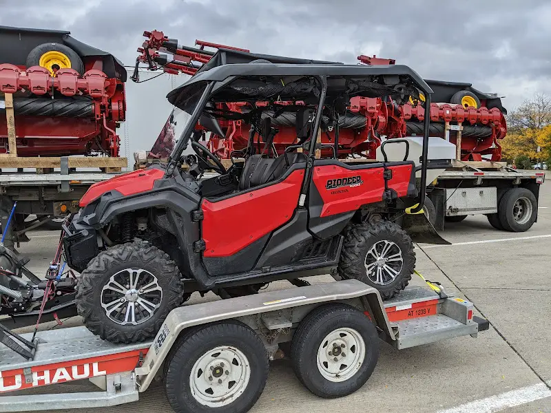

Thanks for the advice so far....of course U-Haul didn't have the trailer I reserved online so I ended up with this..
Murphy's law I guess

Trailer worked perfectly better than I expected.... Now the fun begins...
If you can get the front tie down strap attach points lower down, I think it'll be a lot better. The fore and aft frame rails, just aft of the front end, have elongated holes on their underside. Hooks will attach there securely and will put a lot less stress on the front tie downs.
The front bumper is kind of a fake out. Looks strong, (and is doubtless strong enough for being a bumper) but the attach to frame is all at the bottom - so where you show attaching, besides the suboptimal high angle, is cantilevered up there near its weakest point.
Okay! Congrats on the buy!

I always tie to the A arms out by the wheels. If you tie to the bumper, especially angled up so steep, each bump in the road bounces your machine straight against the tiedown points. It puts a lot more wear on everything.
If your straps come in at flat angles or tie on below the suspension, the machine bounces without slamming against the strap or tiedowns.
