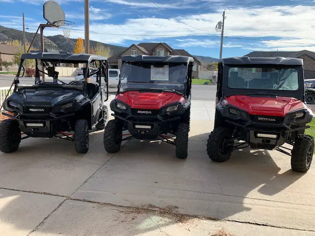

This is just quick note to the Honda SxS forum and the club store. Me and my brother installed these plug and play light bars yesterday on my machine (middle one) his machine (the gray one) and our dads machine.
These went really smooth no problems installing them. Very happy so far.

Very Nice.
I see you changed it around to go under the bar. Fits really nice there.

Yes, under the bar because we believe it provides a little more protection. by the pulling the bumper is required to mount it like we did. It's very simple to pull the bumper though. thanks for a great product.
