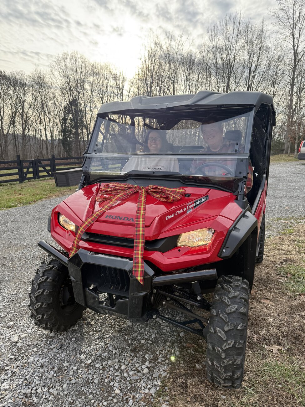

I hear you have to post pics around here or are considered a bum, so here is our Christmas morning first ride.
TIA
The Sleigh Christmas morning 2024

Nice pic! RITFC (red is the fastest color)! Excellent gift choice.
