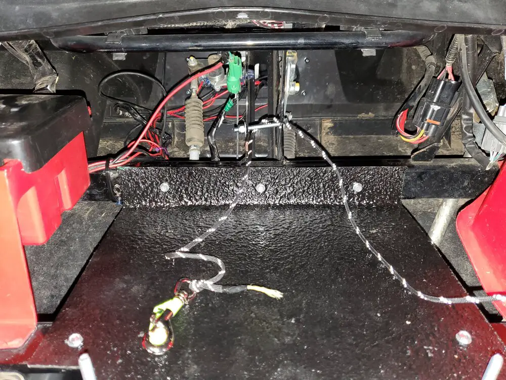

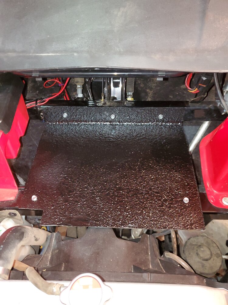

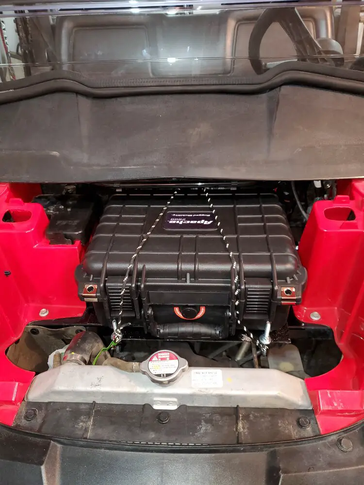

If anybody is looking for storage containers for under the hood of their 700, Harbor Freight has some nice Pelican knockoffs. I bent some metal to make a shelf and fit an Apache 2800 case under the hood. It fits perfectly and is dust and waterproof. I just put some eye bolts in the plate, a bolt through the rear support and used parachute chord to hold it down.

Do you think that a second battery would fit under the shelf? Very nice work by the way, I like quality work.
