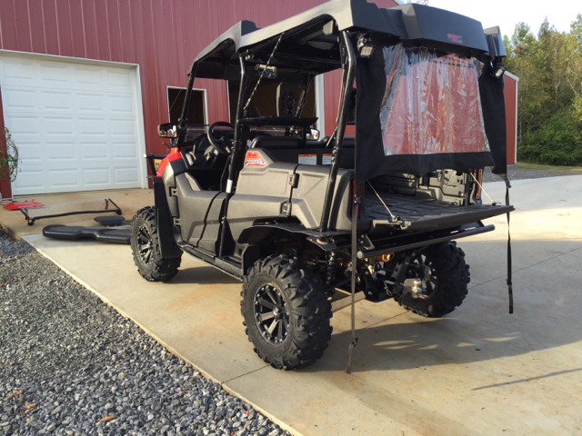

I used 3.5-3.5 on my P700. That's about as far out as you want to go. I really liked it. It was 14" wheels with 28" tires.

Do you have wides tires on front. I just ordered some msa wheels with same offset and after reading I'm a little nervous about rubbing. I also ordered wides on front 28s

I used 28x10 all the way around. But also I had the crappy high lifter lift that was sagging.
Did they rub. I like the wide look better. But I don't want rub. I have the 2" spring spacer lift in front. Thanks for replying. I'm just wondering if I should have gone with a 4+3 or 5+2 instead.

It will also depend on the actual tire size and weight of accessories.
39,129
Gotcha. Mine are true 28s mega mayhem. Did yours rub? I don't have a lot of extra weight just my 215lbs and my passengers. Lol
I had a lot of additional weight from the larger bumper, winch, full-size truck battery, etc.
Also the Evo's that I had were 28 1/4 inches tall. I'm not sure if you will have a problem or not. I probably only had 2 inches of lift after the lift kit had failed me
