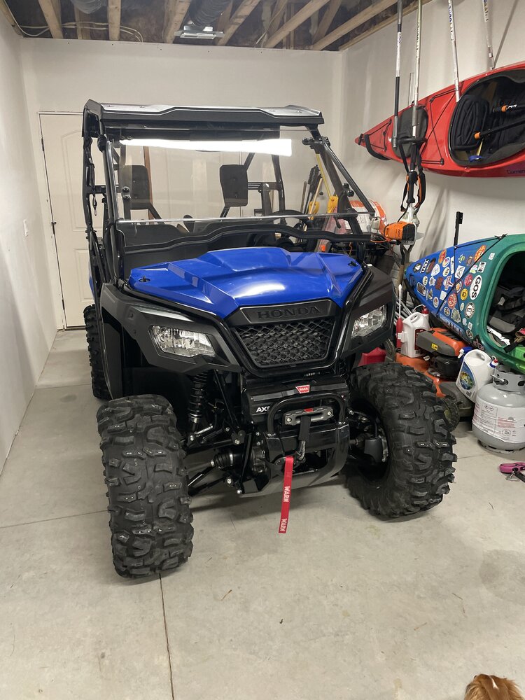

I have an Axon 45-s mounted on my P520. Might be a bit over kill, but I wanted the hand held remote in addition to the normal rocker mounted on the dash. I decided right now to not mount the rocker, and just made the remote plug easily accessible.
20210620 130242256 iOS
I ordered the KFI winch mount and fairlead mount.

Have you considered a wireless Winch remote? Handy controller if away from the sxs, like clearing trails or chores. I’ve never used the wired remote since. PS. Like that blue.
