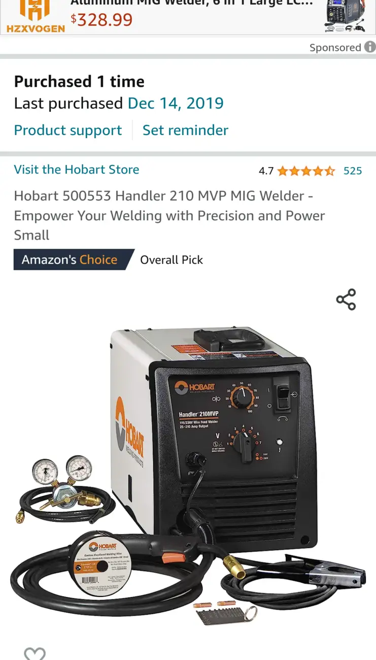

Chrome screenshot Nov 22 2023 5 55 48 PM PST
Another option.
I bought this with a spool gun for aluminum and stainless.
I no longer do heavy repair, so this fit the bill fixing neighbors tractors and DIY stuff.
Simple to operate and find a sweet spot.
115/220 . Miller and Hobart are one and same. 5/2/1 year warranty...
Consumables are quality and reasonably priced too.

That unit does NOT do AC TIG, which is what's needed for most aluminum work.

Well I don't know s*** about welding, but it came with an aluminum spool gun and gas setup for argon.

You most certainly can MIG aluminum, but it won't look as good. Spool guns are often used because aluminum wire jams up between the spool and the gun. But TIG gives you a stonger weld vs MIG, especially with aluminum, and has a far better finished look.
