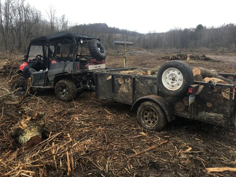

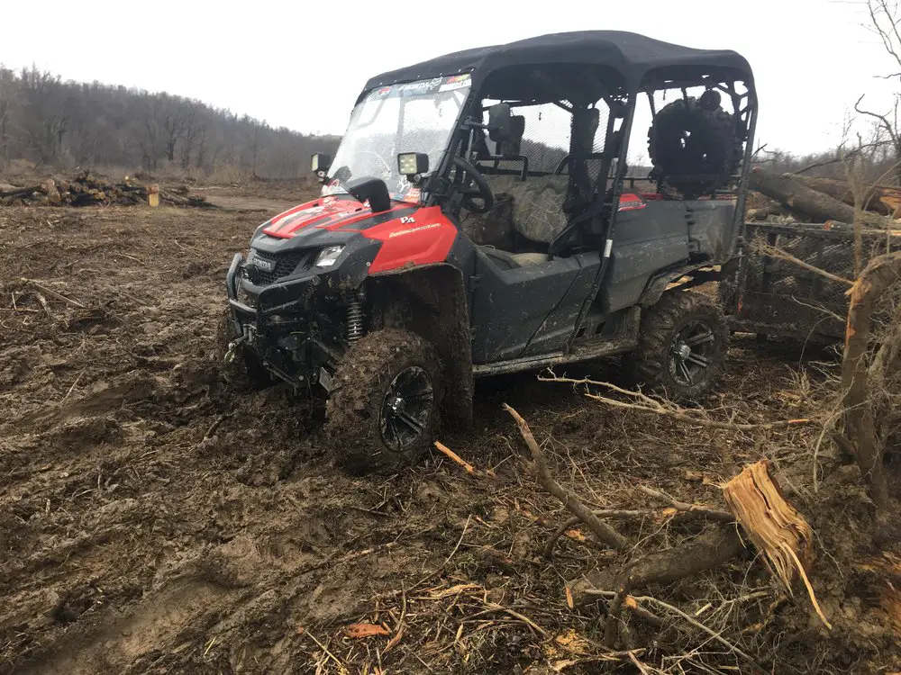

28s will fit
Especially with Ella's or fox
I ran 28s stock.
No bigger unless you find forward arched A arms
But 27s are perfect size if you go heavy mud lugs or put on muddbuster mudd flaps... get a super atv lift too it makes 28s sweet and you then have 13 inches of clearence
Image Image

28s will fit
I ran 28s stock.
View attachment 70569 View attachment 70570
Reactions: swsebek
