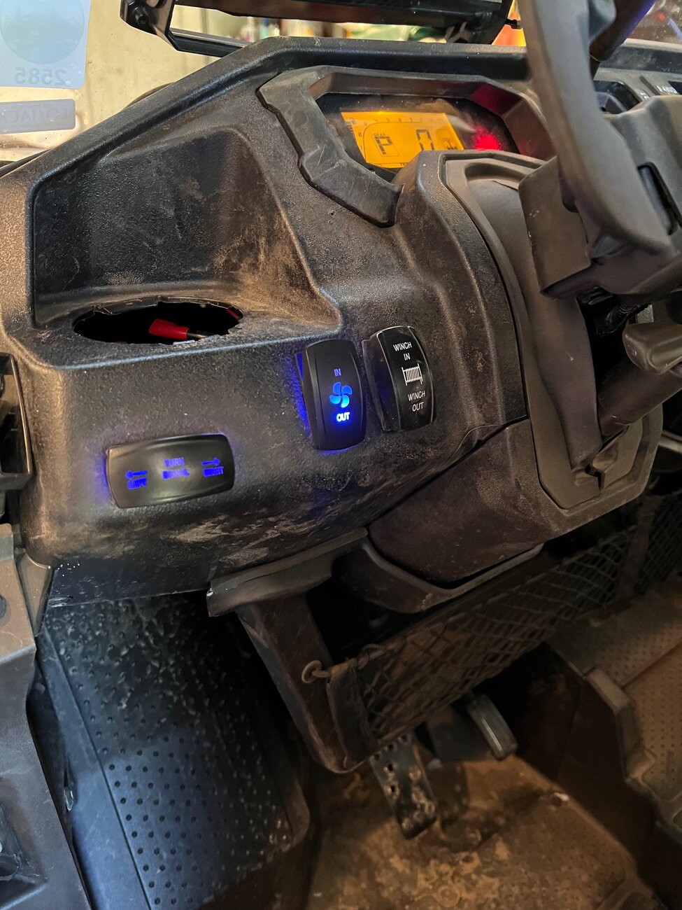

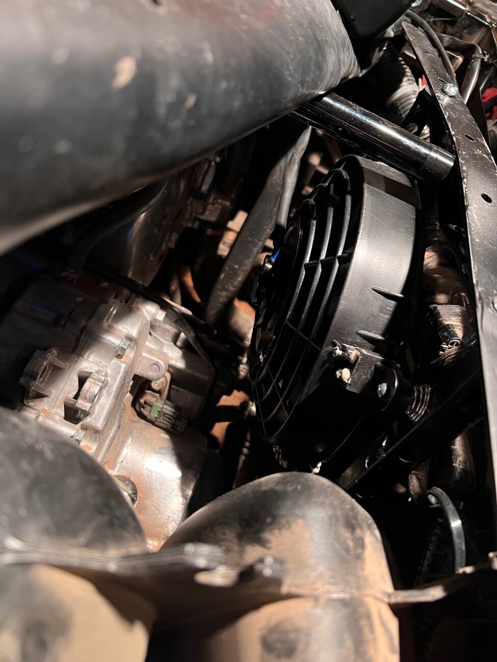

Installed a radiator fan under the seat and a reversible switch.
I originally bought a bilge fan but thought it was too noisy. The 7" radiator fan is quieter and double the airflow.

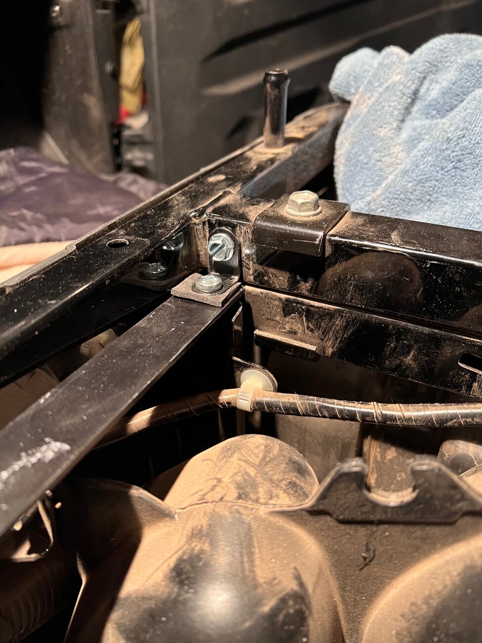

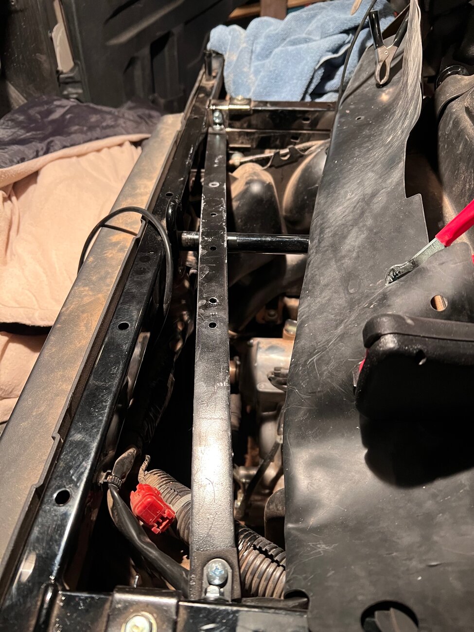

Put a steel bar across the center and bolted it on the sides.
I am still looking for a closable vent for winter use when I'll reverse the airflow to move heat into the cab.
The rubber pads help with the noise and vibration.
I used exactly the same fan and switch. I put vents in also. Nice in the winter.

@Rayger143 are you running any kind of duct or shrouding to direct that heat to the vents? Wondering how much air is moving through them.
Reactions: Rayger143
Rayger143
Rayger143
Aug 5, 2020
3,298
28,783
Winfield, BC Canada
No ducts or shroud. There isn’t a lot of air but I do notice the heat. I’m sure it could be better.
