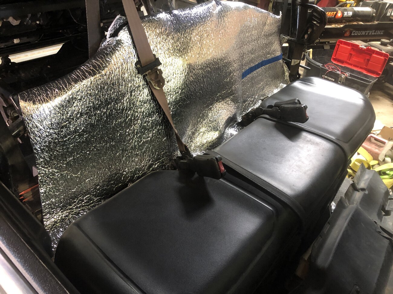

Well, I finally installed a bilge fan and the heat shield. I took the seat back and trim out and wrapped it up and over the back of the upper frame then reinstalled the seat and trim parts on top of the insulation. Don’t know if the heat shield is going to reduce the heat but it sure reduced the sound from the engine compartment! It was worth the effort for that alone‼️
You've inspired me! I bought all the materials to do that, but put them aside and did the bilge blower mod to reduce seat heating. Once I can get up a bit better head of steam (had a heart attack a few months ago I was not even aware of - though things look to be semi-stable now), I'll proceed with the insulation mod.

Yep, that's what I used as well... The roll is long enough to do at least 2 complete coverings of seat, seat back and over the air box. It comes with a little razor knife and some foil tape for sticking it to itself or to surfaces on the buggy...
I put it in place, trimmed it to fit, then placed the various components on top of it and used a punch to push through the various mounting holes to line up the frame holes behind the insulation. Reused the push pins to re mount the body pieces. The seat back proved to be difficult as I wrapped the frame member at top and it is recessed into the seat back... I placed it in position, then got in the front seat and pushed hard against the seat back enough to get the bolts started across the top and sides, then tightened them up one at a time...
Reduced rattles, quietened the engine compartment down... jury still out on heat reduction...
I will also probably line the empty compartment under the seat with it to reduce dust and add additional sound proofing to the under seat area.
