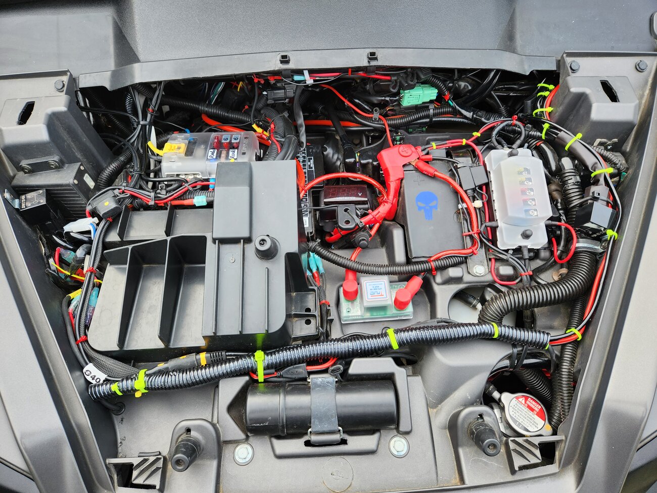

Did a little electrical work. Added USB/voltmeter, dual battery setup with isolation, small light bar and interior lights. :)

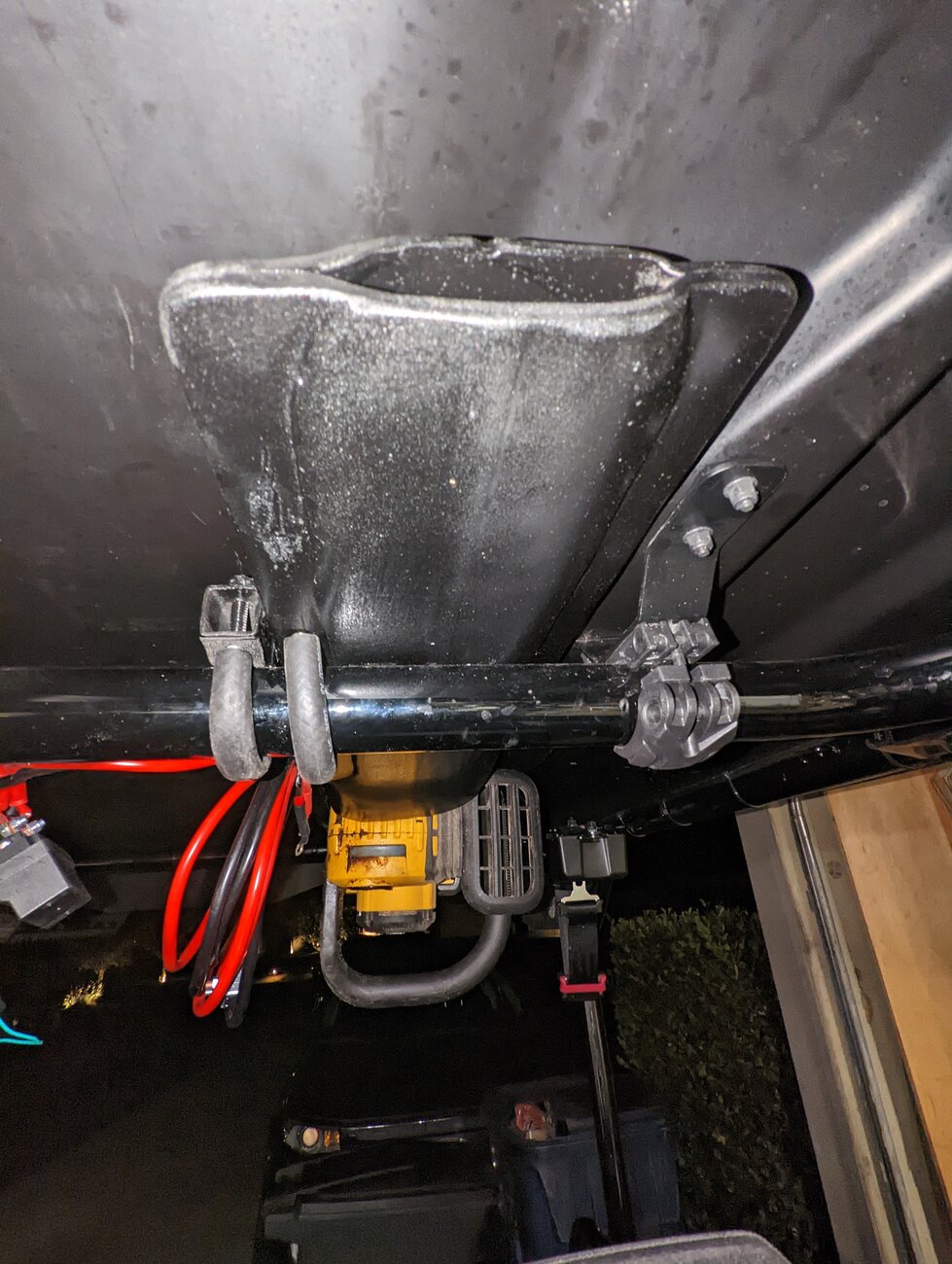

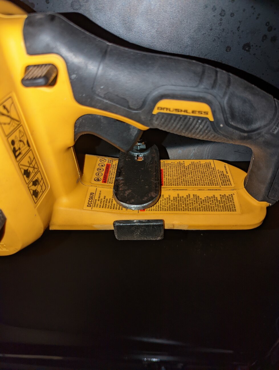

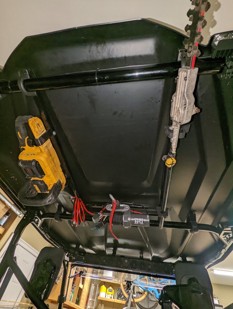

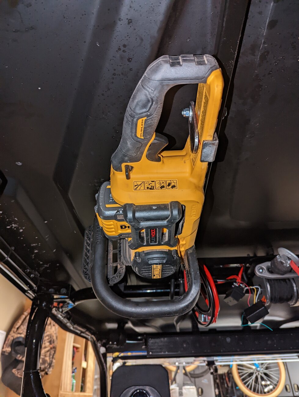

Added an upper game winch to the roll bar, fabbed out of 1x1 square tubing and bar clamps, using a harbor freight wireless winch. It provided the modular platform to add chain and pole saw mounts, using 4" PVC for a scabbard and Quick Fist Clamps. Saw keeper tab is keyed for removal (push up to swing it back) and ensures a tight fit for both the quiet DeWalt and the 20" Stihl. 3/8" fuel line on every circle clamp keeps it rattle free. The saws fits tighter than a frog's ass, no squeaks or rattles...

@fernandw what did you do, heat up and flatten a 4" pvc tube to make the scabbard?
Yes, Sir. I used a bit of 1/2" ply as a template around the blade, used a bit of 1/2" inside for the bar/blade clearance, heated it up in the grill and clamped it together. Gave her a little sanding and painted with bed liner in the can from the Depot. Thought I took pics during the PVC forming, but I did not...
