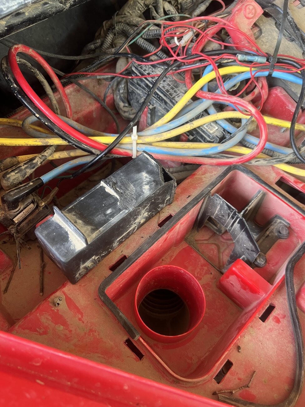

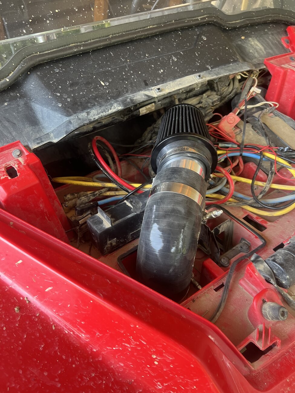

IMG 6793
IMG 6790
I copied parts list from previous posts. I cut the relay box off the old air filter box. Trimmed the corner down a little. I wanted to get the air intake a little higher and away from the front of the hood. I almost flooded it in Tennessee this year. Didn’t want a full blown snorkel going through hood. I had to bend filter down to clear the top of the hood or to keep it from bulging out

From Amazon.
ETL INDUSTRIES
11 inch pipe would have been plenty
90 Degree Elbow 4-Ply Thickness 5mm High Performance Coupler Silicone Hose for Auto with 2PCS T-Bolt Clamp Black Color (ID:3.0"(76mm))​
Universal Clamp-On Air Intake Filter, High Performance, Washable Filter, Replacement Air Filter, Flange Diameter 3inch/76mm Black.​
Not sure if this will be the right filter long term but it looks cool.
Except for the filter I used the search bar and found these parts.

Straight Aluminum Pipe Polished, OD 3" (76mm), Length 18.00" (457mm) Exhaust Intake Tube Tubing Universal Seamless Round Intercooler Piping.​
This if the first part. I think the length you need to go out the hood with snorkel.​

View attachment 438368View attachment 438369
I took my rig out putting trail cameras out yesterday, I like the sound I get off that new filter when I get on it.

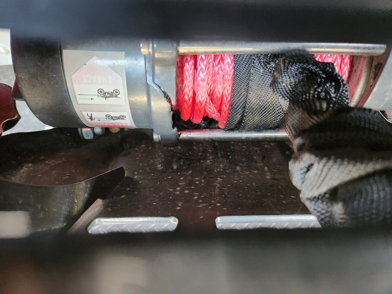

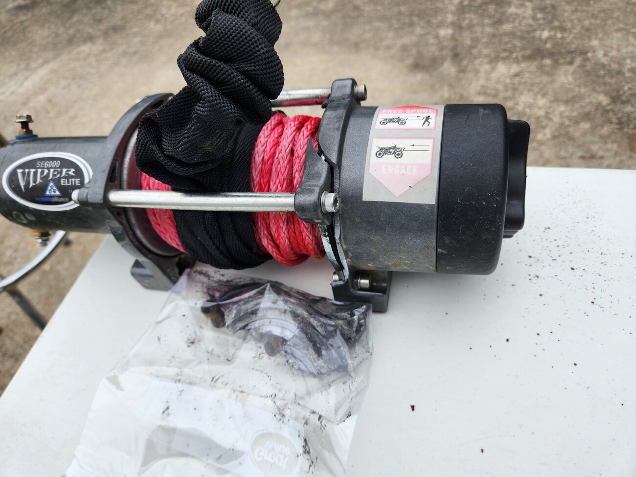

Ah..Dammit, I just broke my Motoalliance Viper Elite Widespool, 6000# winch housing.
Totally my fault - winching a dead, flat tired pickup out of the way, at an angle..s***.. I hope I can get parts for it.. I hate to buy a new winch.
Guy ought to know better..
Grenaded my drum too.
Off to Motoalliance for repair.
Your wiring gives me the shakes! Lmao
