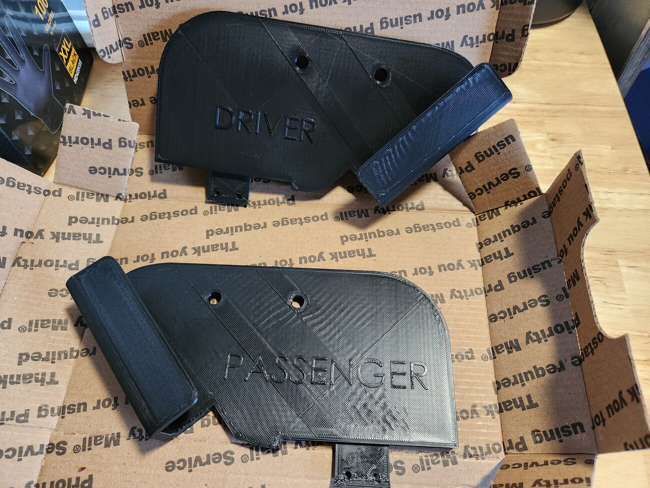

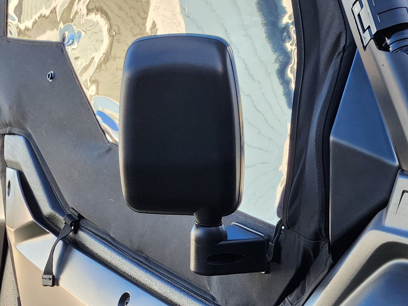

Honda OEM Mirror mounts with soft upper doors.
These could likely work with any mirror' mount bolt pattern.
Contact @tjoreo for a great engineered solution to mirror mounts for Honda Soft Upper Doors.
These 3D printed mirror mounts are made specifically to fit your Honda Pioneer and Oem soft upper doors.
The quality is excellent and the design is intuitive to real world accessory fit.
Made by a forum member for the benefit of us all.
Dirtstiff approved!!
Thanks again!

Gen 2 for sure.
I'm not certain if there is a difference in the support frame between gen 1 and 2.
My guess is they are the same or similar and will work.
I believe @HBarlow has the Gen 1 upper doors and the brackets worked fine for him.

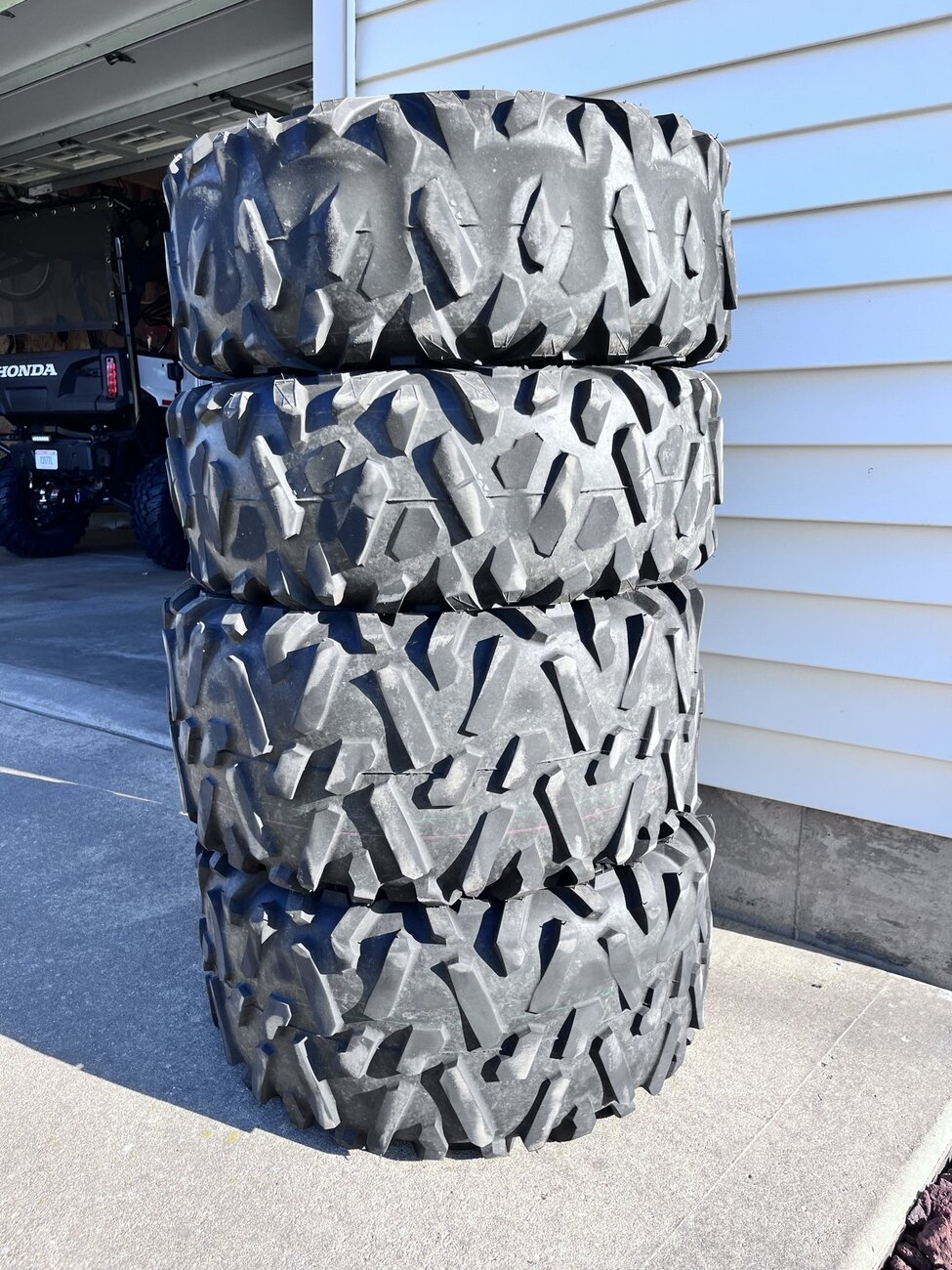

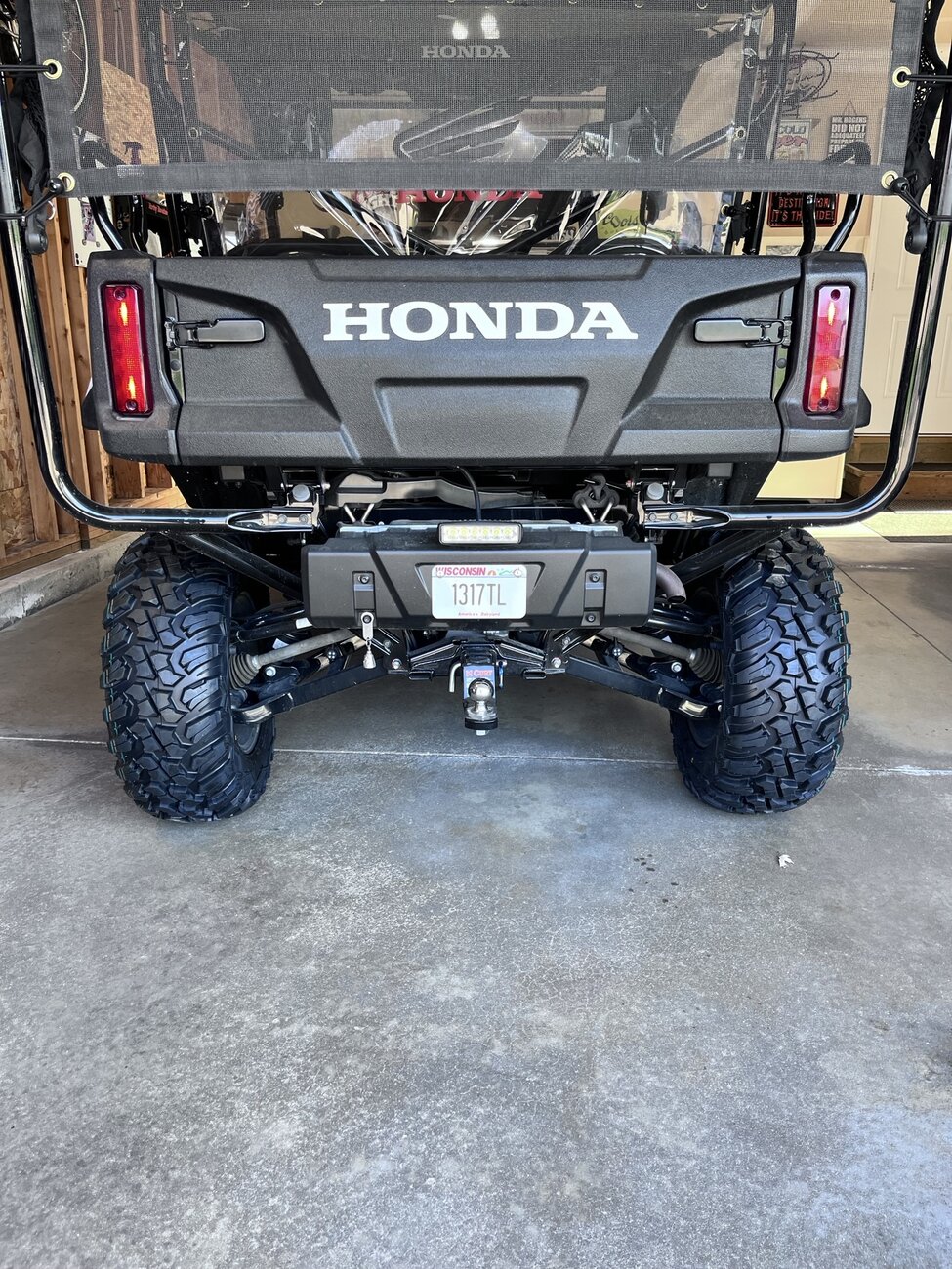

Long time no see!

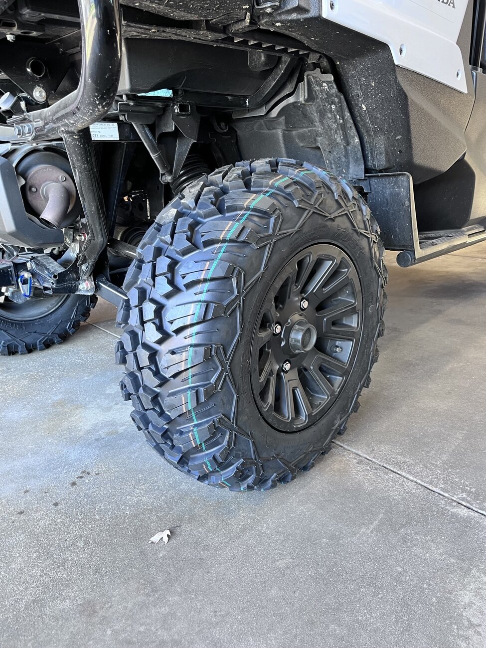

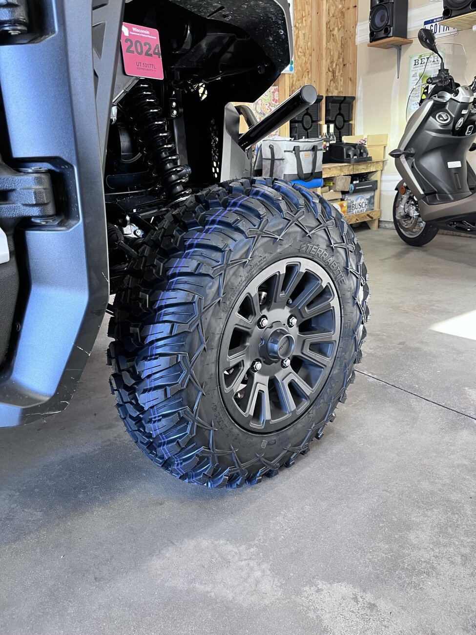

Today was the day I replaced my stock rear Bighorn tires, after 9,051 miles over 3 riding seasons. Last year I bought a couple Wanda clones for the front which were very worn, as the rears were not ready to go. The plan was to have cheap fronts wear out in one year to keep from buying all 4 until this Spring. That worked great, I got another season out of the rears and the Wandas lasted 2,500 miles - one riding season.
I installed Tusk Terrabites in stock size on the stock wheels. I have 17 psi rear and 16 psi front. 3 pounds over recommended 14/13 respectively. I rode across town up to 40 mph, and I can say the tire noise is absolutely gone! Soooo quiet now. I hope to get many seasons out of them.
Any suggestions on running the Terrabites based on your experiences? My Pioneer is a road buggy and rarely sees off road beyond grass and a little dry dirt.
IMG 2797 IMG 2798 IMG 2799 IMG 2800 IMG 2801 IMG 2796

I added balance beads to mine and running 17 psi seems to be the sweet spot for hard pack ride.
X rotated mine last weekend at about 1200 miles.
Negligible wear all 4 tires.
19mm tread measured with guage = .75 tread depth.
Zero air pressure loss with beadlocks.
Good luck 👍

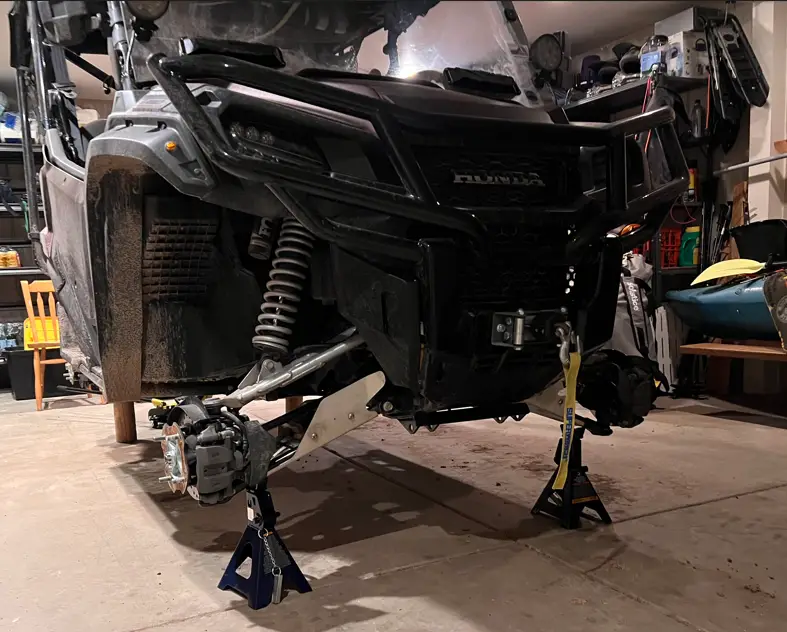

I put my 2021 P1K5 LE up to swap out the tires.
1714349114051

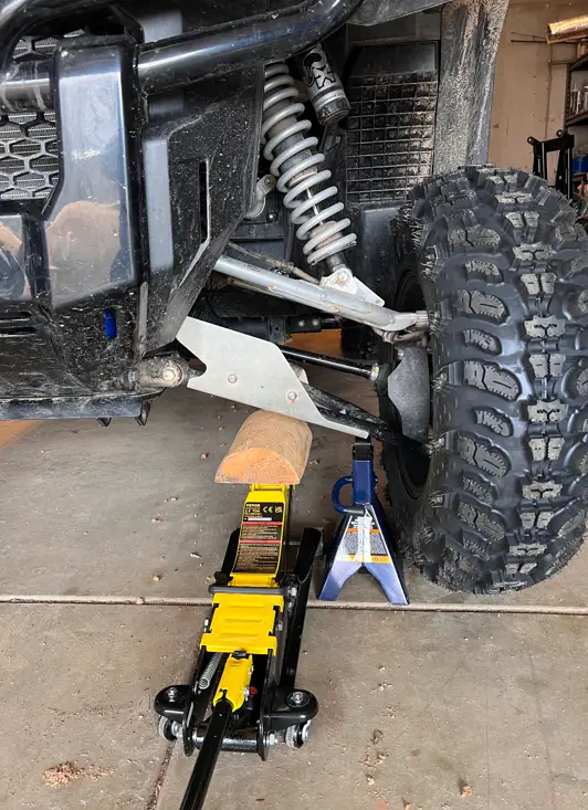

I used a couple of left over deck posts and the floor jack to keep it in the air.
1714349341160
If you look, there's a half-cut deck post on the top of the floor jack to lift the rig.
The LE stock skid plates are a bit tough to find a good lift point on the fronts and rears.
I think a bit of 2x8 or something would work just as well. Just span the arms.
It let me lift the machine without bending the skid plates.

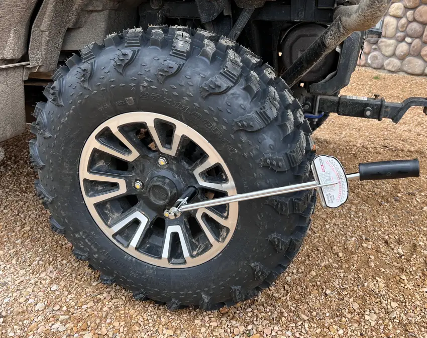

My Honda manual said torque to 80 Ft pds. Here's my super-duty, laser precise 1/2 inch torque wrench on the job.
Please note that the lugs are in a bit deep and you may need an extension or a deep socket.
