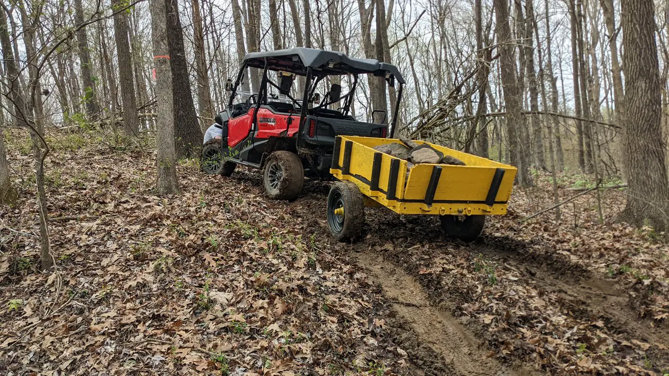

I hauled rock out of the creek today. NOTE TO SELF - "It's too wet to haul rock out of the creek." I did get to try out my SATV winch for the first time though. Took me 3 separate pulls to finally get up the hill. Winch works great, very pleased with it's
performance

That's a pretty good load! HA!

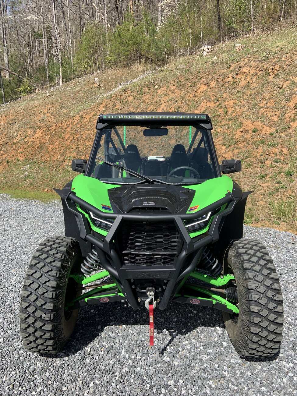

(I'm running the stock a arms with 814 shocks. l needed to get a little more ground clearance and didn't want to change a arms or buy new rims. l gained 2" overall. I searched all over if the 29's would clear and couldn't find anything except everyone said that the terrabites run small, so I tried them. At 8psi they measure 28" high. And it definitely changes your ratio. So, if you want a different tire, I would stay with a 28" just to be safe. Let me know what you end up with!!!)
l sent this to Dirtstiffs-1000 a few weeks ago. I still haven't had a rubbing issue and they're so much quieter on the road. And at 12psi they're still 28" tall My only complaint is that they seem to flat spot after sitting for a short period of time, but it doesn't take long to get rid of that.

I'll have to do that, thanks man! I'm looking forward to them, probably sometime iIn the summer. I wonder if I can burn up the stock ones by then... 🤔 I give the stock tires some credit, they are taking longer to wear out than the bighorn 2.0's I had on my ranger. The fronts got ate up quick.🙄
