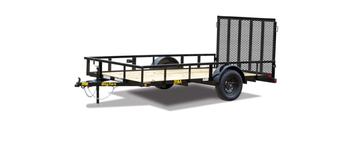

You'll need a trailer with a minimum size of 6 1/2' by 12'. 6 1/2' by 14' will allow a little extra cargo space and might be better
This is what I bought:
I wanted short as possible for easy storage in my garage.

Thanks for the info. Probably not gonna haul anybody else’s stuff on the trailer. Kids are all grown and have their own equipment. As i said earlier only gonna haul my sxs and golf cart. I have another 10’ trailer to use here on the place. My longest haul would be to the lake (2 hours) away and the camp which has me leaning to the single axle trailer and maybe even aluminum to make it easier for me to move around.

I think the minimum for a P1k-5 is 12 feet. You can go as small as 10 if the tailgate doesn't hit the machine, but 12 feet gives you a little more room for gas cans, gear and tongue weight balancing. I saw the OP's tow vehicle was a Raptor, so weight isn't a big deal.
I had a heavy dual axle trailer behind a 4Runner and decided to pay a bit more for an Aluma 6812H (68" inside width and 12' inside length) with the "H" being a heavier 3,000# axle. They also make a 14 footer, and that would've been a good option, too. I either had to buy a bigger truck or a lighter trailer. I installed brakes, but you wouldn't need those if towing with a Raptor. Going to a smaller aluminum trailer saved 1,100# of weight I didn't need to lug around.
The trailer weighs under 700#, I can move it around by hand, and it doesn't have to be registered (no annual tax) in Utah. This is my Teryx4 on the trailer. My P1k-5 is a little wider and shorter, but still fits perfectly.
