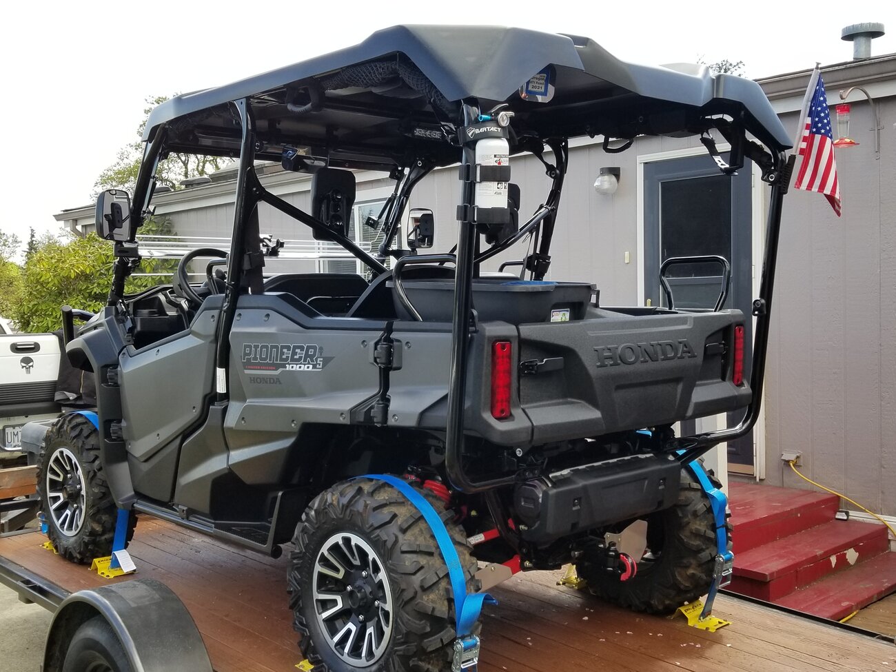

I have an Aluma 6812H.
It's great for an open carry (yep) with an added ebrake behind my 4 Runner.
Can't haul too much more than my 2021 P1K5 and stuff, but it's just right and below the weight where I'd have to pay annual registration in Utah. [Pic is of my Teryx 4 on the same trailer)

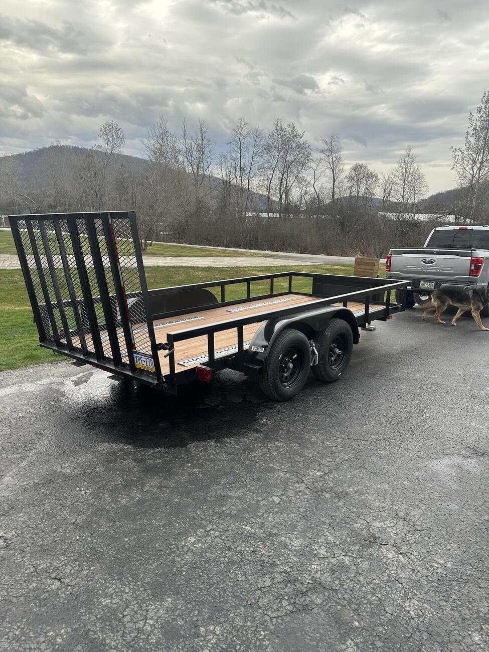

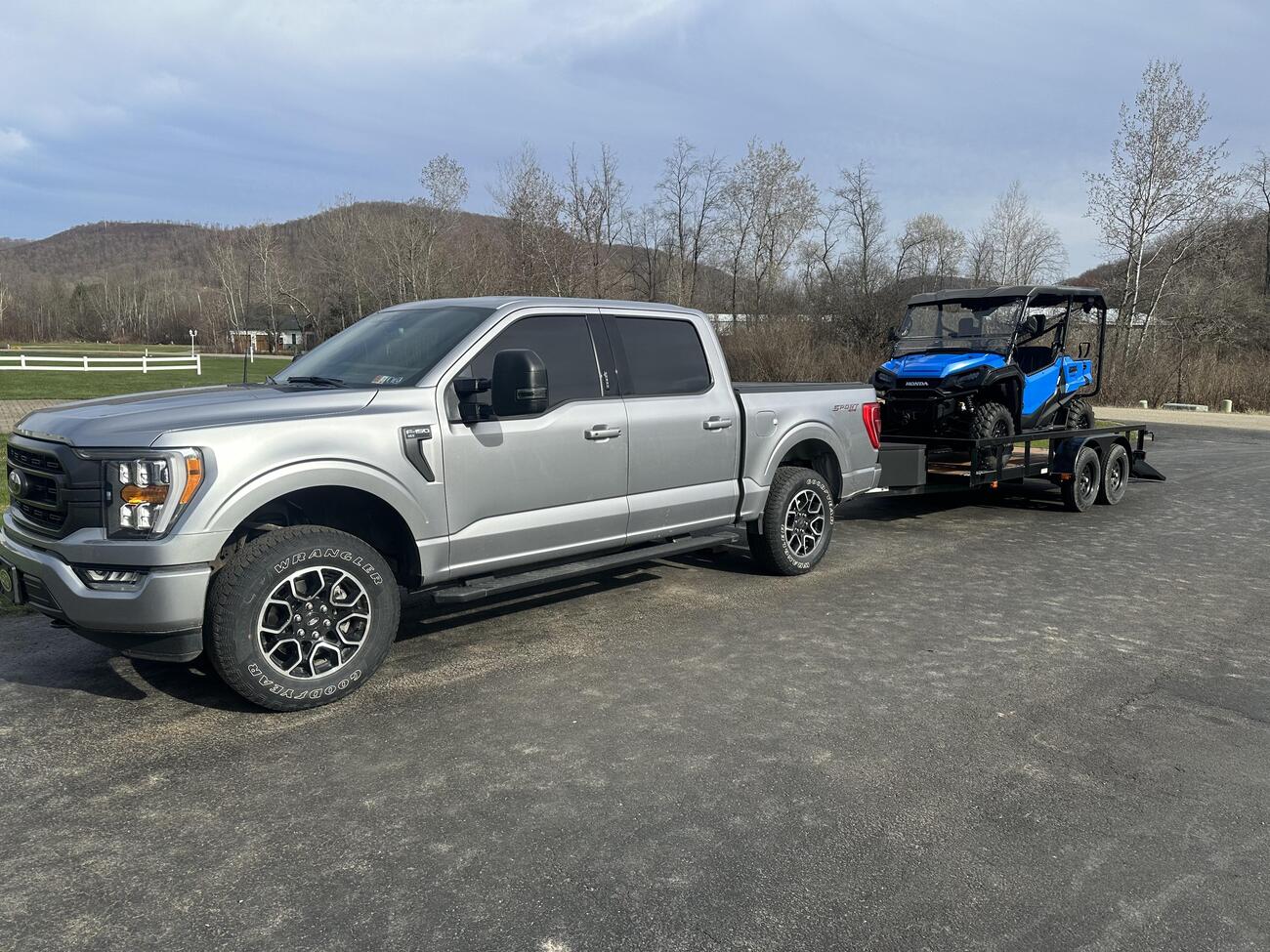

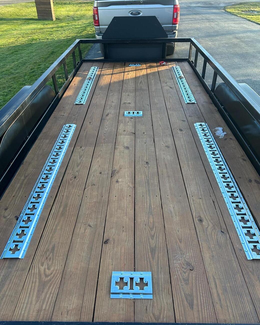

  1. Looking to buy
I found a 1 year old tractor supply Carry-On brand,
tandem axle trailer on FB marketplace for $2800. I went tandem as it’s my only trailer and can be used for anything else necessary! I added X tracks to it and found short 8’ straps just to use for the tires. No big mess when trying to unwrap or wrap them when finished. I’ve always been one to go a little bigger than needed. I plan to have a youth bike or atv on the back for my kid in the next few years. 5501a39532b7d18e27cb7c57ef236702
