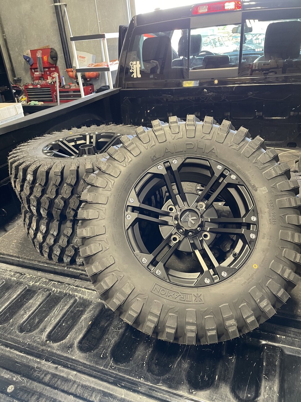

In my opinion, I would just buy some some aftermarket 5+2 rims with 1” spacers in the rear. Then buy some A/T tires (lots of options). With this set up you can run on the pavement nice and smooth ( a lot of these tires are DOT approved) and off road in mud, rock, sand etc. and not worry about having to swap for different applications. With this setup you can rotate for even wear. With the amount of miles you put on this setup would last you a very long time.
