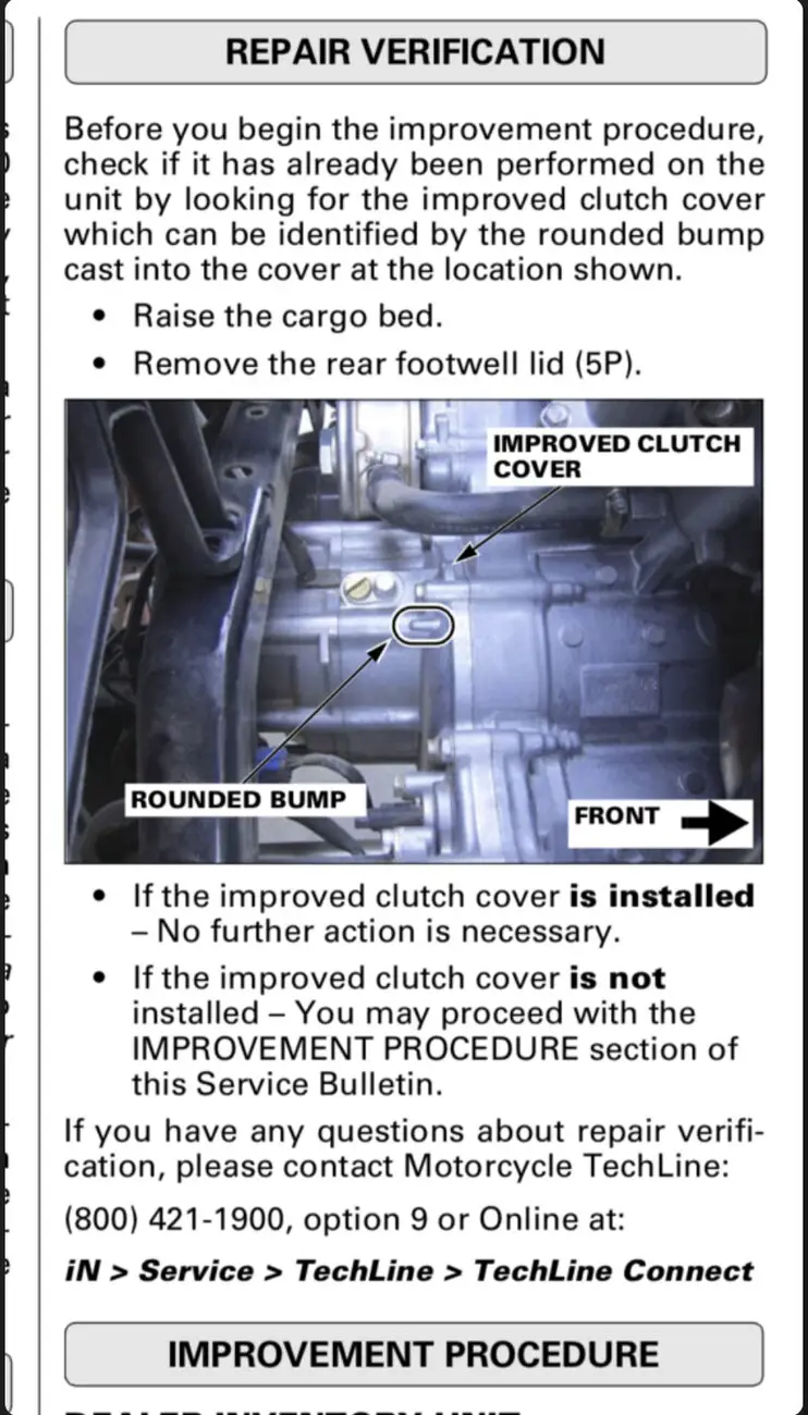

Yeah that clutch campaign has ended. Should have been a recall imo.
If hasnt, might be worth the $$ to have it done before an issue arises .
Here is how to look and see if it was done
IMG 5175
Also, the seat heat thing is a joke. Get u a quick shield instead. Much better

I will get this done this week when it goes in for service
Thank you
