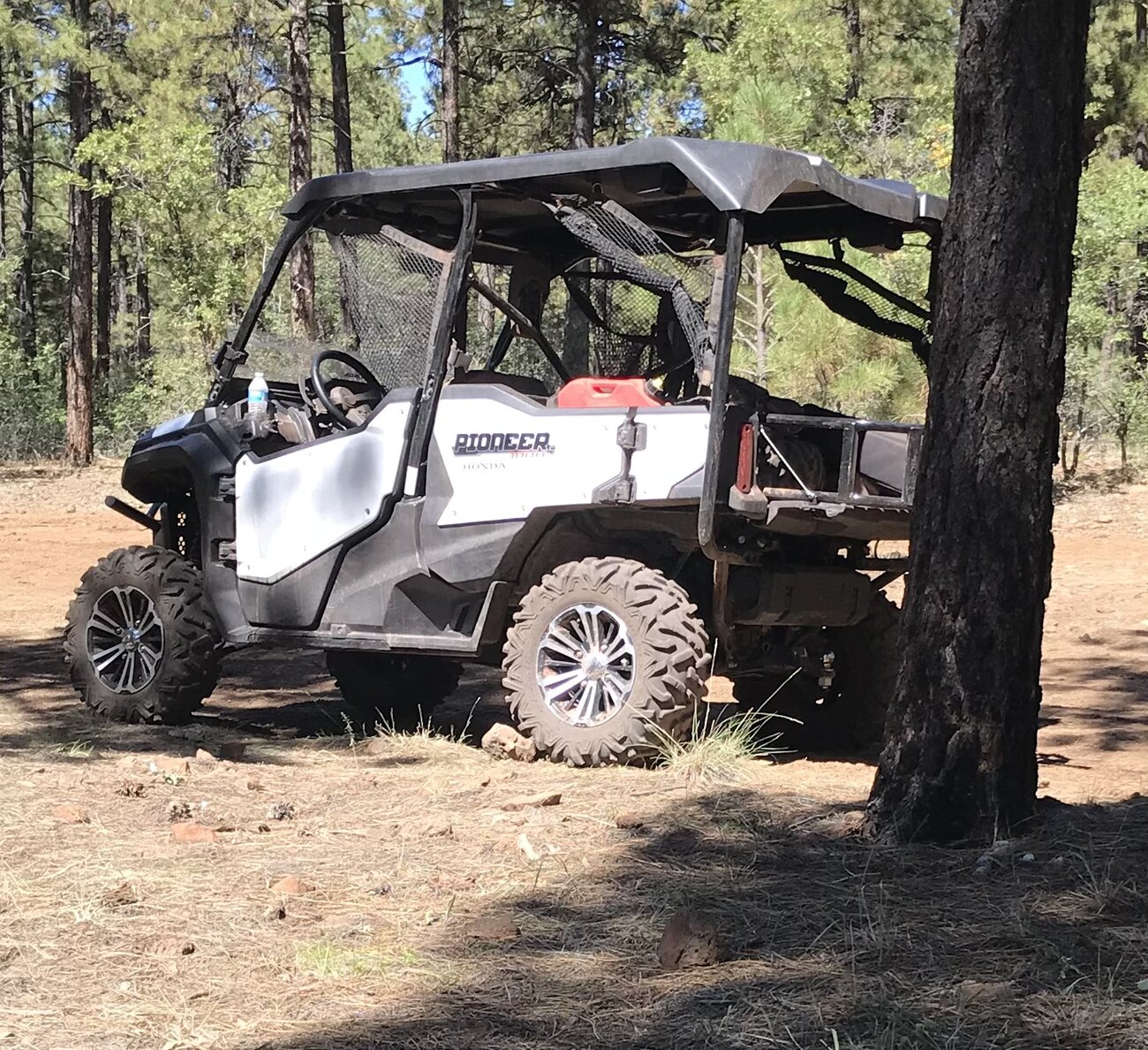

Thank you for the information and the welcome. I added my pictures maybe it takes a day to update I can see them
IMG 0696 IMG 0655
