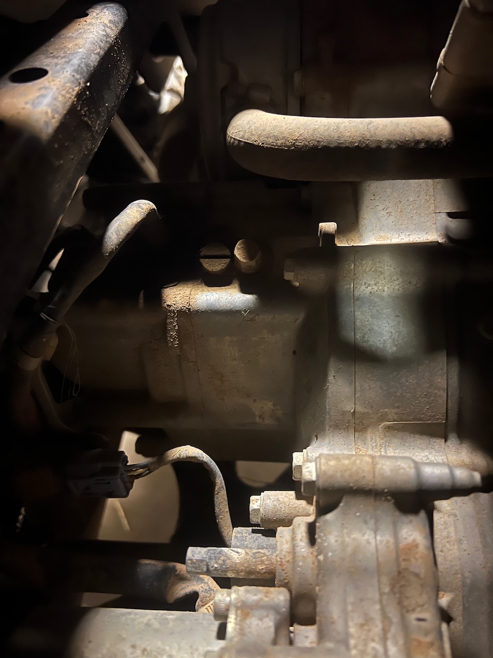

Well, just checked and the bad news is that the clutch housing on my 2016 P1K5 is the original version.
IMG 9240
Good news is that it is 8+ years old and has 3,220 miles on it and evidently it hasn’t ever had any clutch problems.
Bad news is that odds are that it will have issues before much longer.

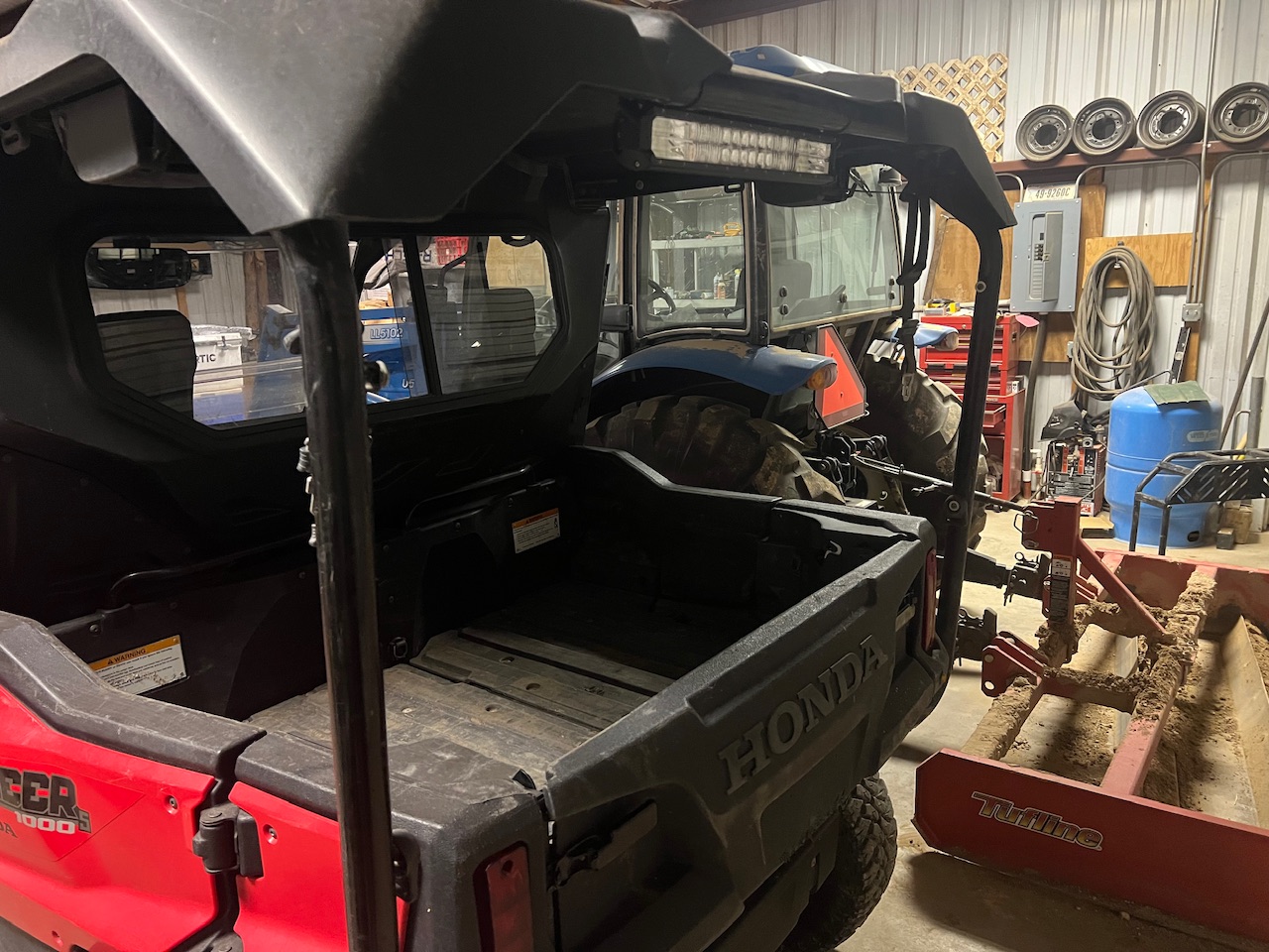

Started the process of adding my own touches to the machine. 20” LED light bar on the back.
IMG 9241
Not as excited about doing all the adds now that I know I’m going to need to spend some $ on the clutch.
