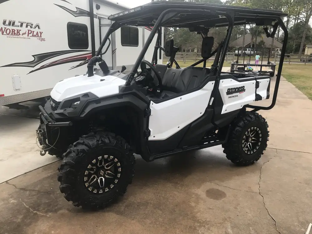

Does anyone have 30" tires on a 1000 with HL a arms without a lift?
I'm running 30" blackwater evolutions with just the HL arms. No rubbing at all and you keep a low center of gravity with no lift.

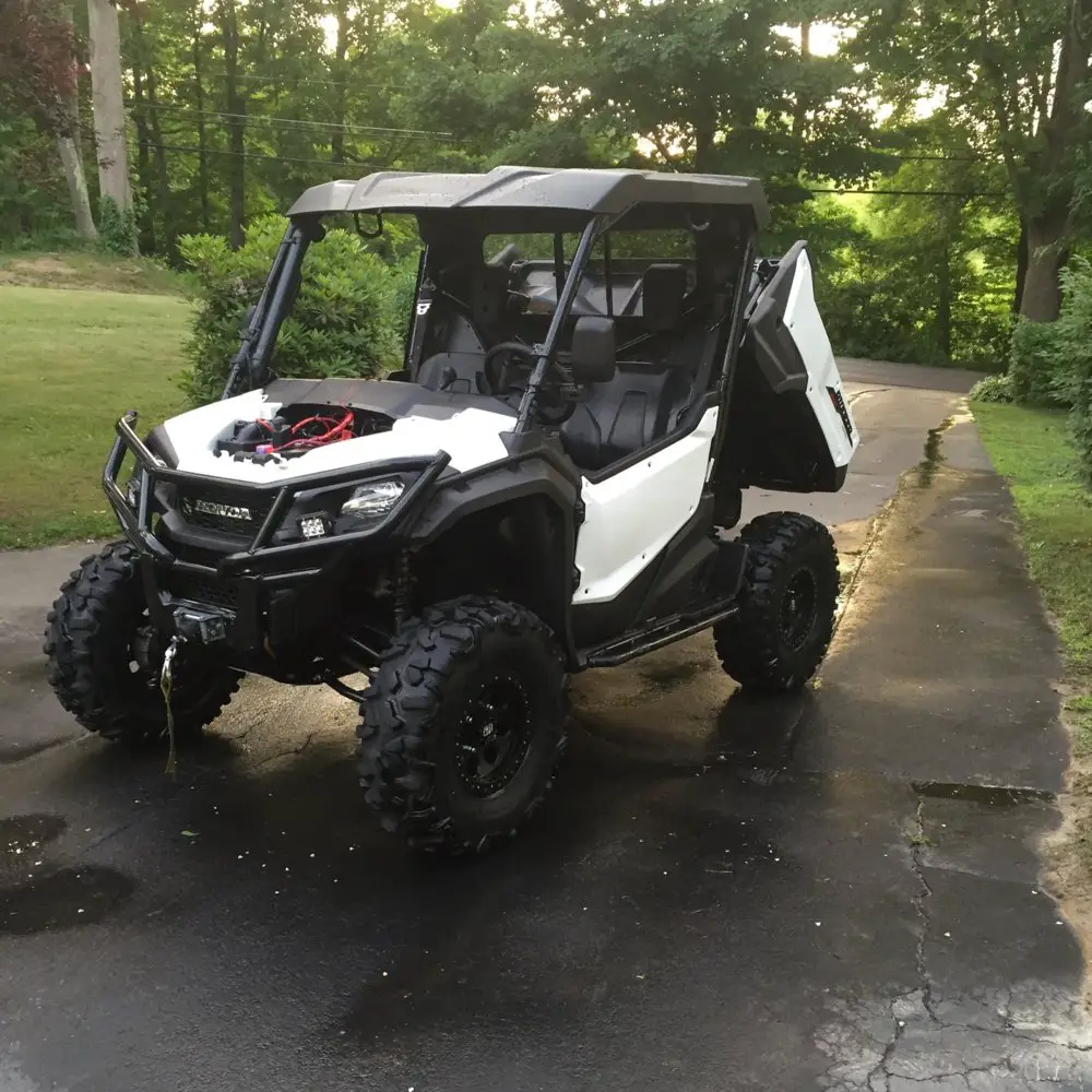

I'm running 30" blackwater evolutions with just the HL arms. No rubbing at all and you keep a low center of gravity with no lift. View attachment 32502
I just put 30" bighorns on today since I installed hl a arms last week. I had the same thoughts on maintaining the lower center of gravity without lifting.
Thanks for the picture looks good!
