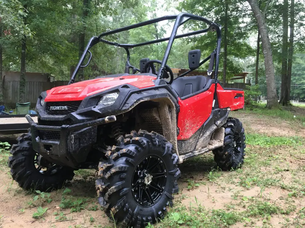

Almost 31". U definitely need lift and a arms to run 30 intimidators. That's with 8 psi
Wow, thank you very much. Right now I've got the CATVOS system so I should be good but I don't know if I want to go with a tire that big. I've got the 30" roctanes but sometimes I wish I had more low end power for hill climbs. I'm looking to go ~29". But those intimidators look to be an awesome tire.

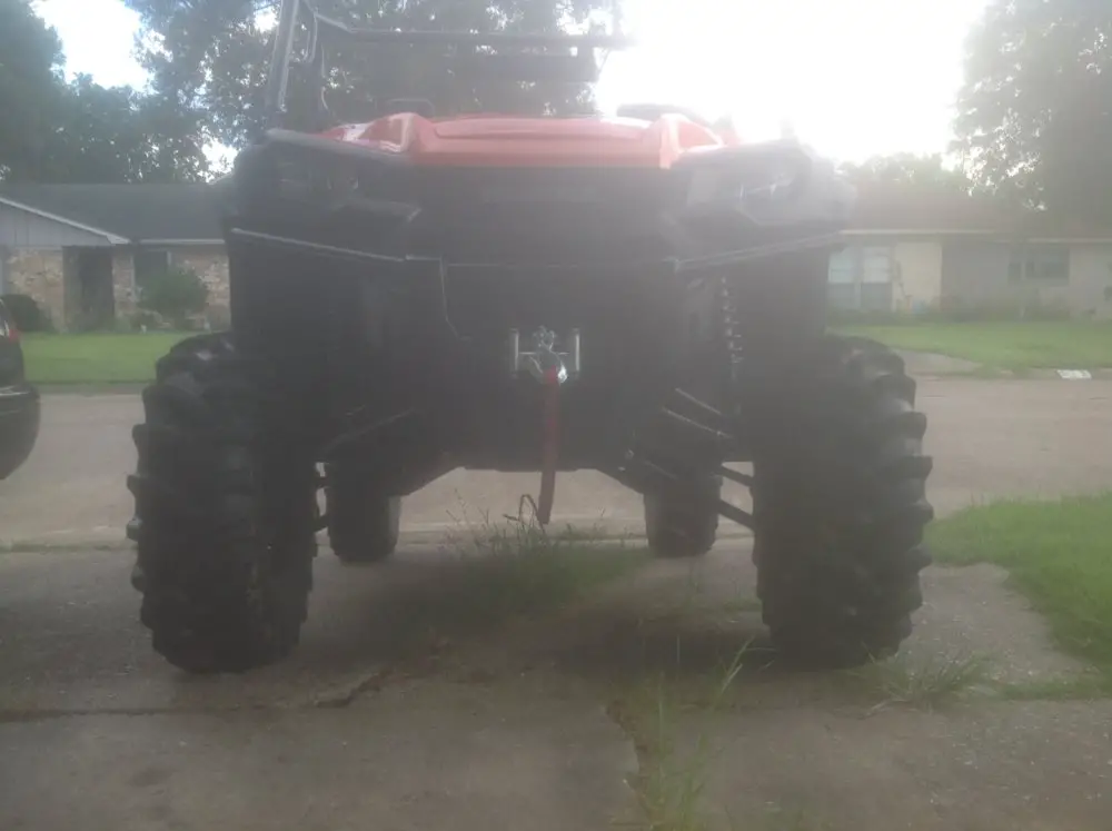

I just placed an order for 30 inch intimidators. I have the high lifter arms and the high lifter 2.5 lift.
Will I have any problems?
You already ordered.... We'll know soon... I would think so but some things I've been wrong about before. What offset rim or are they going on stock?
I don't think you will. Mine fit with just lift and rub at about half turn but the HL arms r supposed to move tires forward 1.5" and with that they should clear fine. I have a arms in the shop I just have to find time to install them. They r a very heavy tire and at 31" they r going to rob ALOT of power from the machine

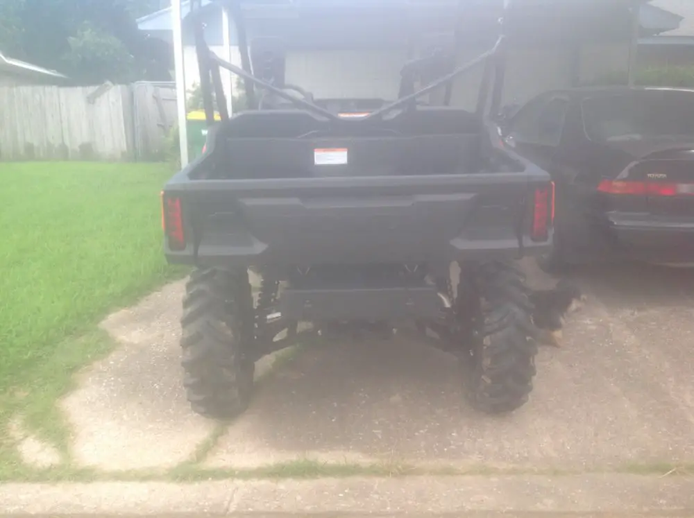

Looks great! How is the bike handling the 30's in the mud? I'm wanting 30's also just wanted to see how the bike is handling the 30's before I order them.
It doesn't really like them in reverse if u get in any thick mud. It will spin them great in low but the intimidators r a really heavy tire and they measure almost 31"
