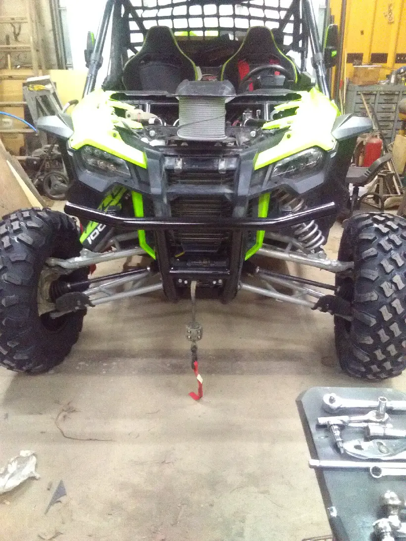

Well this upgrade turned in to a headache!
Took alot longer than expected. Murphy's law was in full effect.
Once all back together checking for CV bind I found out there was/would not be any. With 6-1 offset wheels they hit the stops on the a arm before the CV can bind up. Gained about 3/16" of turn both left and right setting it with 1/8" toe in. Was afraid there would be no improvement in turning radius. Measuring it the turning radius gained was right just over a foot. Would this be enough to notice?
This past Sat July 1st, I was able to take it to a place I regular ride 3 or 4 times a year. There are 3 turns that in the past had no choice but to use reverse to make them. Gained enough turning radius that I did not have to use reverse to make any of the 3 turns. So I achieved what I set out to do.
Power steering. The Super ATV is great. Even in 4wd over ride, you can turn the wheel with 1 finger. I have one of the Talons that stock turned easier to the right than left for what ever reason.
RB3 1.5x rack. This rack makes it nice ripping through the woods not having to turn the wheel as far and makes the Talon feel more precise. But combined with the Super ATV power steering, the Talon is a handful at higher speeds on back roads and asphalt. You just have to think you want to steer and it steers alot. Would be very easy to over compensate and then start sawing the steering wheel back and forth and loose it.
Overall very happy with these upgrades. My drive shaft caps had not started spinning yet, but the 2 fab drive shaft gives me piece of mind that I won't break down on the trail due to loosing the front drive shaft.

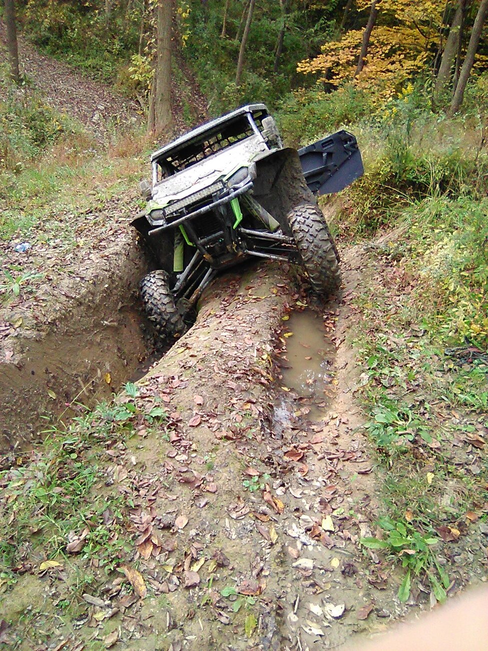

Here is a couple shots with the megabites. They are not wearing as good as the terrabits on the road.
