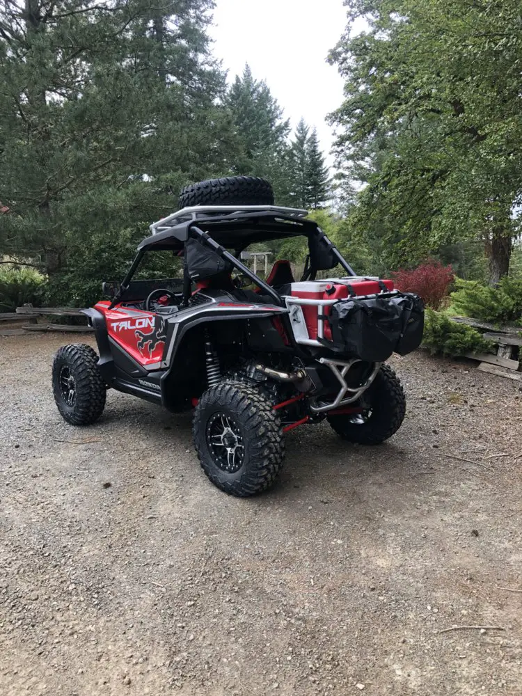

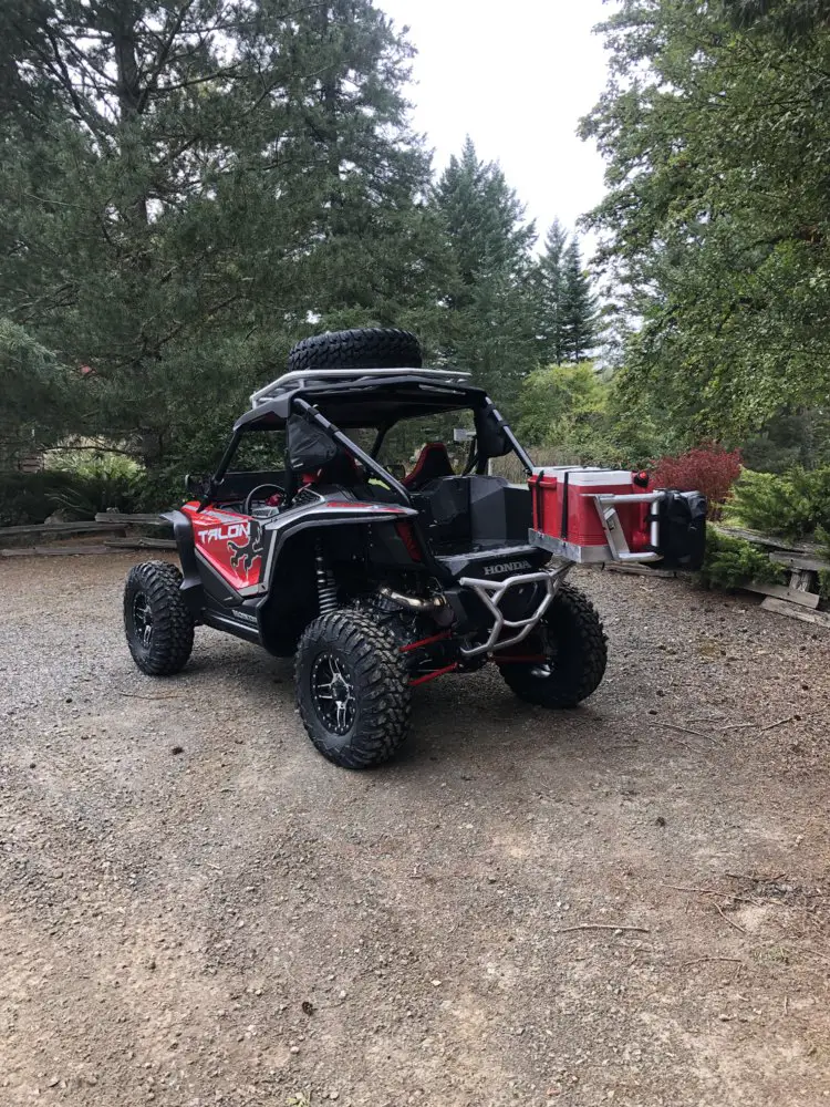

Build update pics. Got tired or the excess heat coming in the cab from the radiator. Moved everything to the back. I still have a little bit of heat coming from the rear in the form of a backdraft. I have yet to cure that part. By moving the radiator, tool box, and second battery to the rear, it’s helped the balance quite a bit. No pics yet, but I also installed 2- 4” blowers up front and ducted them to the foot well on each side. I haven’t used them on a hot day yet, but the forced clean air from upfront should cool the cab down even more.
