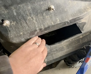

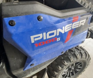

Honda changed how the panels mount for 2022. I was still able to add storage and all, just had to adapt a bit.

Good video I am actually going through the same thing right now with my 2022 trail the issue is I don’t like how your panel sticks out from the main door. I would like to get it as tight as factory. I’m looking for a flat nut to go on the exterior currently.
If anyone else has any great ideas to fix this issue, please suggest .

I agree, that's sub-optimal using a nut and washer on the outside. As you said, has the color panel sticking out too far. The fix I'd use is install rivet nuts in the door panel. Use a washer only on the inside. They sell rivet nuts with a larger outside flange that still has the threads almost flush with the surface. Then proceed as normal (previously discussed) fitting the color panel.
I also recommend either small O-rings on the ball end shaft to seal on the inside surface of the button to keep dirt out of the button mechanism.
Update: after a year of use. The O-rings work well, but require a bit more force to compress each o-ring to get the button to snap into position. I found that washers made of closed cell foam-rubber sheet work even better. I could not find an on-line source for such washers . . . so made them.

You're gonna like it. Be sure to read back through this thread as there's a lot of helpful info. I used an oscillating multi-tool to thin the back side of the door covers, at least to the point that the nut on the push button would be fully engaged with the button threads (even at the back). This gets the color panel as close to the door as is reasonably possible. I used a hole saw at the corners of my planned cut out (no sharp corners), then cut between the holes for the opening.
