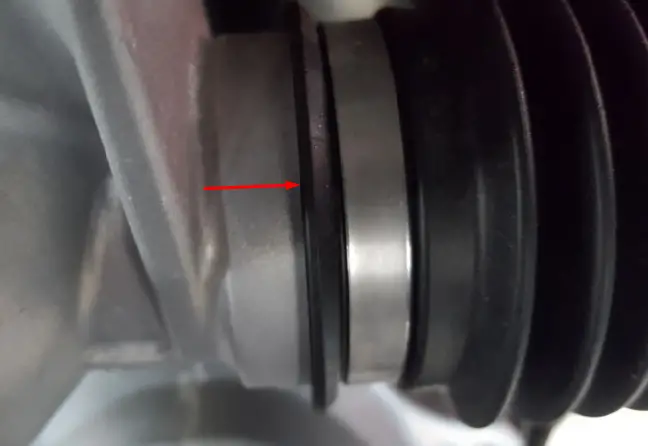

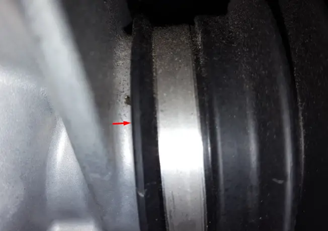

The rack housing is wider on the R and it restricts movement. This causes a difference of 6 degrees inward and outward turning radius...
X housing looks like this...
R housing looks like this...
I have installed the Talon X rack on mine and I am waiting on Turner Axles to get my axles done. I keep having issues with the shaft coming out of the inner CV joint. The inner joint is not failing and the shaft isn't coming completely out of the inner joint just make a popping noise like a broken axle but it is not broken.

I think the issue was compounded by the arched a-arms and the limited steering of the 1000r. I hope to have it back together soon but I had to take most of the front driveline out to swap out the 1000r steering rack for a 1000x steering rack. Now I am waiting on turner to get my axles done so I can put it back together and I will do more testing.

Update on this issue.... After swapping my 1000R steering rack for a 1000X steering rack it is alot better. I would say that is the Best MOD I have installed on my 1000r.!!
Are the stock Talon axles doing what you described above or is it a set of Turner Axles doing this?
Buckwheat
Buckwheat
Oct 18, 2015
40
75
Sorry for the confusion. I was having issues with the stock Axles before I swapped over to the Talon X Steering Rack.
