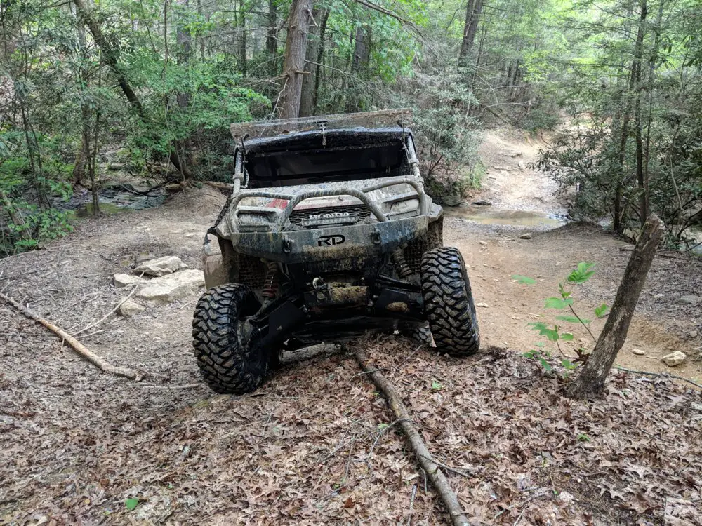

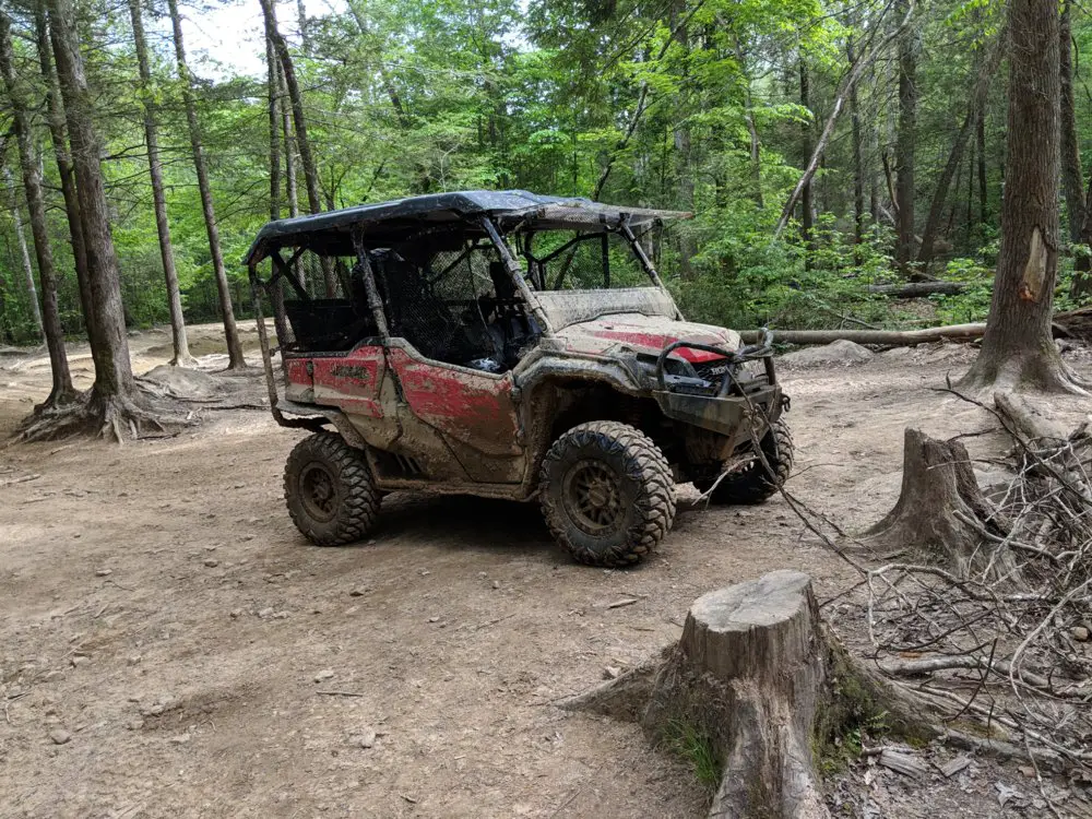

If you do the Quadboss QBT846 in a 28x10 on 14x7 5+2 wheels they should look like this
IMG 20190503 164538
IMG 20190503 131210

I have fox shocks with stock arms. I never tried them with stock shocks
Well looks like I'm about to try em with stock shocks! Just canceled the 27x9x14 and 27x11x14 and ordered 4 of the 28x10x14.
Thanks for the pic, btw. Exact same rig as mine minus the front bumper. Well, and fox shocks apparently. Same windshield and everything else looks-wise though. That gave me the perfect shot of what mine will look like.
