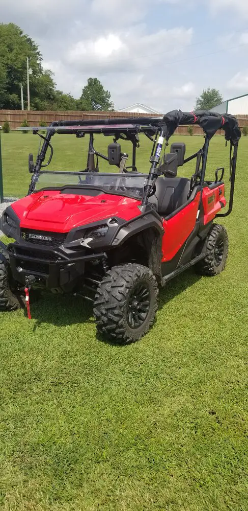

Wanted to give update
I put the set of front wheels on all 4 corners with no issues other than the 27/9/14 felt and looked to narrow
I also put the rear wheels on all 4 corners with no issues, 27/11/14
The front tires do stick out about 1 inch past flares and tracking is probably that much off but visually unnoticeable eyeballing 30 to 40ft away looking from front or back
I'm probably going to try this set up for awhile till I need to replace tires
No spacers are being used so far
Once I go with new tires I would like to go with 28/10/14
Has anyone used the stock rear wheel on the front with this setup
I still have the front wheels to play with if the taller tires rub with the wider wheel on front
Thanks

Here is some pictures
20200829 130229
20200829 125522
20200829 125354
20200829 125158
mwj1969
Jul 19, 2020
4
9
Kentucky
Lucked into these on FB guy was only 30min away 500 for set off 2020
Found part # at babbits but would look for take offs locally
