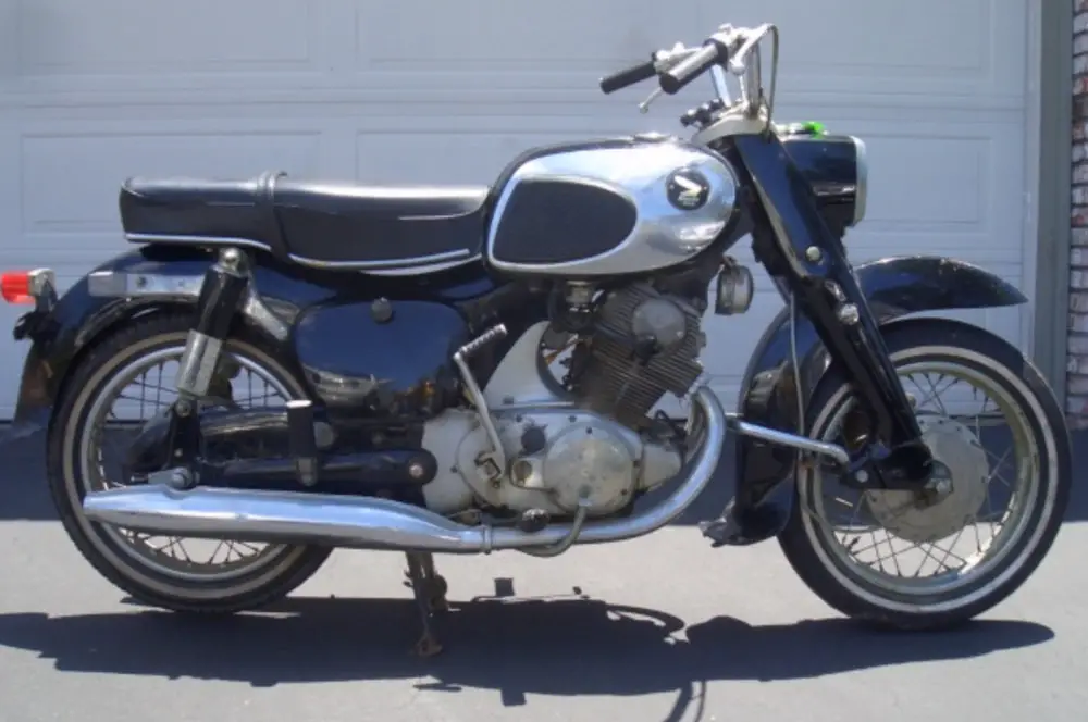

This is a long shot here but on many occasions on old dirt bikes etc...I've removed a spark plug grabbed it with a pair of pliers and heated it over a flame until it got red hot then reinstalled and started. It's an easy thing to try...never know what may happen.
Had to do that often as a kid when my first $50 “dirt bike” had bad rings and would oil foul the plugs.

Just grabbed a similar pic. Thinking it was a 1965 150 Dream?.. two cylinders but prior owner had but rings in wrong way. Bike was a step up from a mini-bike. So glad to have something with a clutch.

My dad had a blue Honda similar to yours Mudder. I think it was a CB160. It had a really almost too soft suspension.
