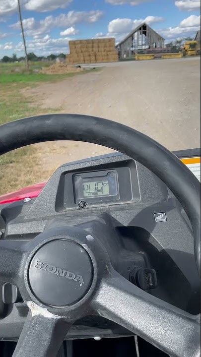

I'm thinking its something electrical because after I replaced the torque converter and oil pump but before I took it all apart and cleaned the screen it would shift but would slip due to the still clogged screen.
It doesnt give any check engine for flash anything on the guages when i drive it.
I can upload a video of what it drives like.
I also tried screwing in the emergency valve just to see what it would do and it drives the exact same, makes me think that its just stuck in limp mode. It felt like it was in 1st gear but it could be in second, idk been awhile since ive had the thing running good enough to tell haha.

Here’s the YouTube link, like I said it creeps when I put it into gear, the emergancy valve is not on in this video, and gets to 12-13 and dies like in the video. Thanks

The little "grrrr" sounds like it's trying to shift. Maybe cross-shifting (trying to engage 2 gears at once). There is a thread on here somewhere about this.
Also: go and find a Rincon service manual and download it. They go into much more detail about the hydraulic circuits for each gear, etc. Why Honda didn't include those in the Pioneer FSM I don't know.
