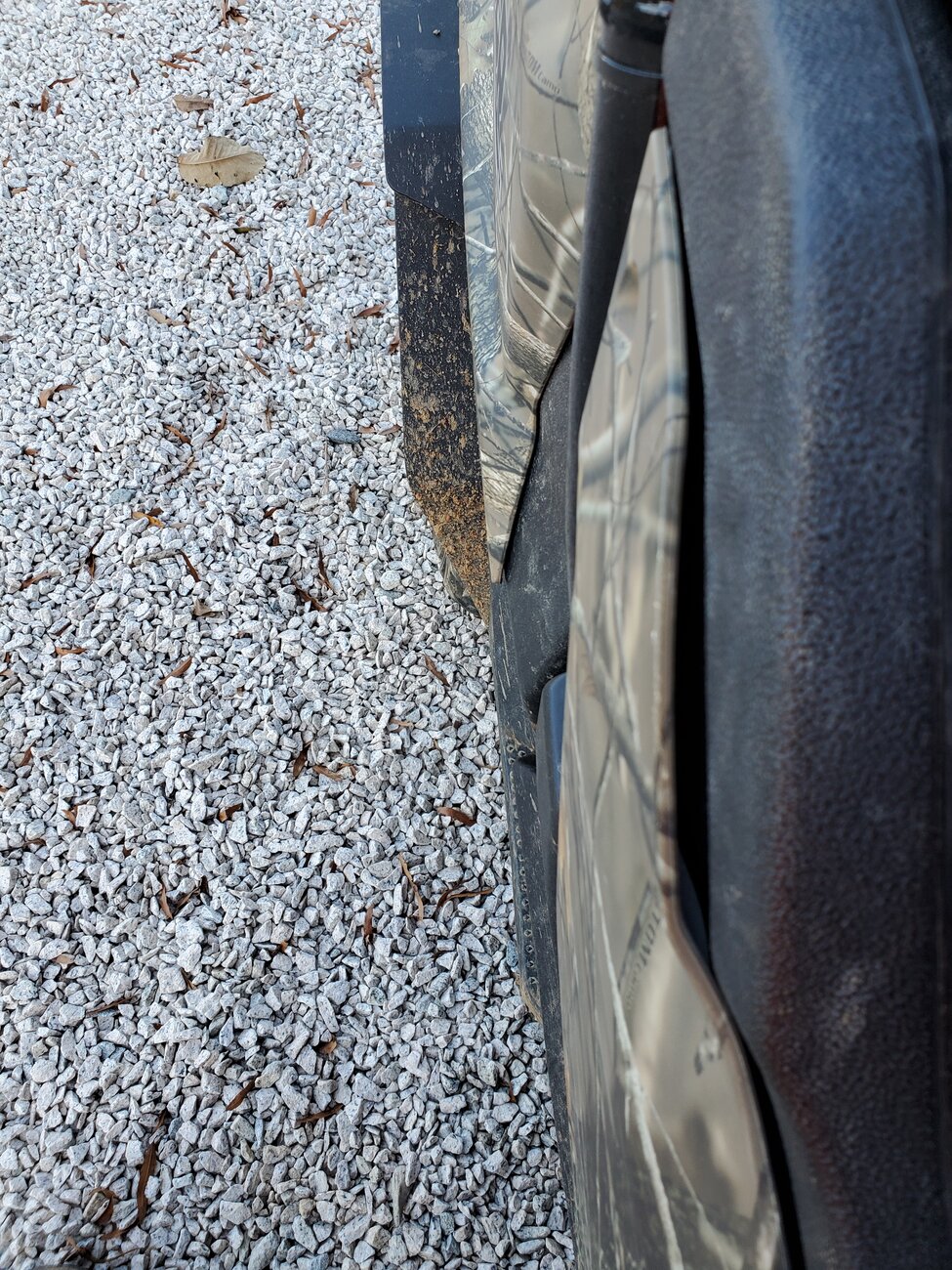

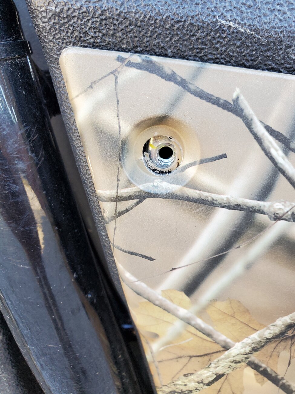

Here's the passenger door, you can see the fastener in the upper front and how the other two holes become progressively further off. Both door panels and both bed panels have the same problem.

Here's the passenger front door on my 2018 1000-5. It has the gap like hondatech mentioned. My panel doesn't go all the way to the back of the door like yours does. If it did then the bolt hole in the door would be covered by the panel. Seems like yours are too long
20211226 145057
20211226 144909

@packer58 I tried moving my panel all around but couldn't duplicate your issue. The gap on mine looks worse in the picture than it really is. It measures 3/8". I've thought about adding a bolt there to close the gap. Has anyone tried that?

Wow.. that one is off by a inch.
Yeah, it's off by quite a bit for sure. I know we're not talking space shuttle tolerances on a $20,000 rig but dang-it Honda.... you gotta do better than that !!
I guess at this point i'll keep returning them till they get it right, it sucks but i'm a patient man............
Side note...... The front end piece and hood fit like a glove....
