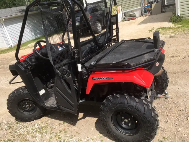

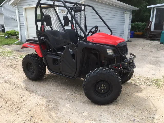

Replaced my 25s with 27s today and everything works great! Thanks to all for the information you guys gave me. Tires came off a 2020 Pioneer 1000. I had them installed on my stock rims.

No spacers and it seems very stable. The ride is smoother and no problem with gears. I have about 12 lbs. pressure in them and was wondering if I could drop it down to about 8 without a problem?
